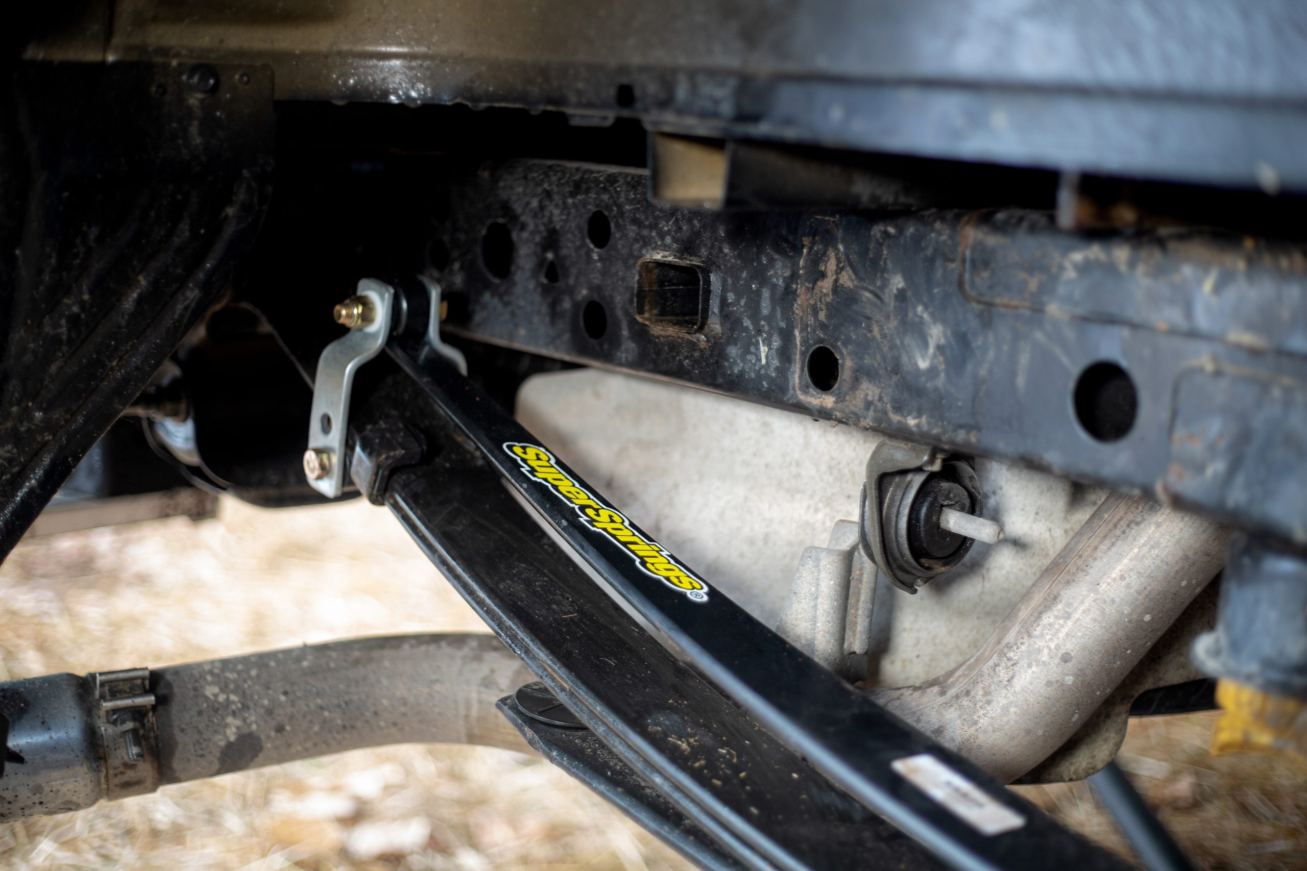

    Maybe, but I did Google "SuperSprings" and there is a product https://www.superspringsinternational.com/supersprings/
    I do have SumoSprings on my truck now. A bit bouncy when unloaded but rides real nice with minimal squat when I'm towing my boat. I decided to add RAS because I will be adding a bed rack and tent this year and I want to try and eliminate the slight squat when towing.

    There are SuperSprings and SumoSprings. I have tried both and like the Sumos better. With the SuperSprings, it will raise the rear nearly 2 inches, but they do what they are meant to do. Another benefit to the Supers is they act similar to a sway bar, but you are going to lose some articulation as well. I'll be listing the Supers on the classifieds one day, just haven't got around it.

    I've heard that the Super Springs will leave me with a 1.5" to 2" lift in the rear when not towing. But in two videos on the RAS, it appears that I may end up with this rear lift as well. I guess my only other option would be to install a leveling kit. Good, I will use this real world opinion and evidence to prove to my other half that I need yet another mod on the truck! Lol

    @thumper_racer states 2" with the SuperSprings. With the RAS I have heard you will get less lift in the rear but it will depend on how much you gap the spring. With the HD kit that everyone seems to go with at the thinner disc you end up with 1/2" of lift and the thicker disc you end up with 1" of lift.
