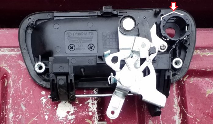

    The frame is what cracked on mine. Handle/latch was still operational though.

    Handle breaks in half so there is nothing to grip when trying to open.

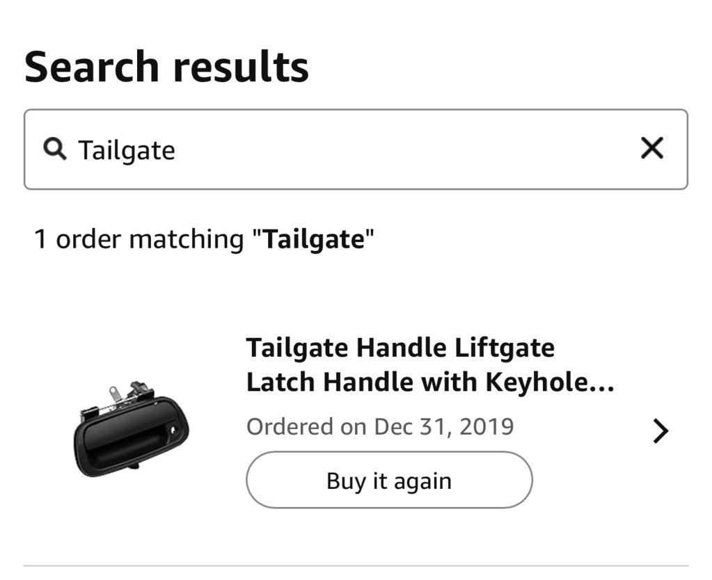

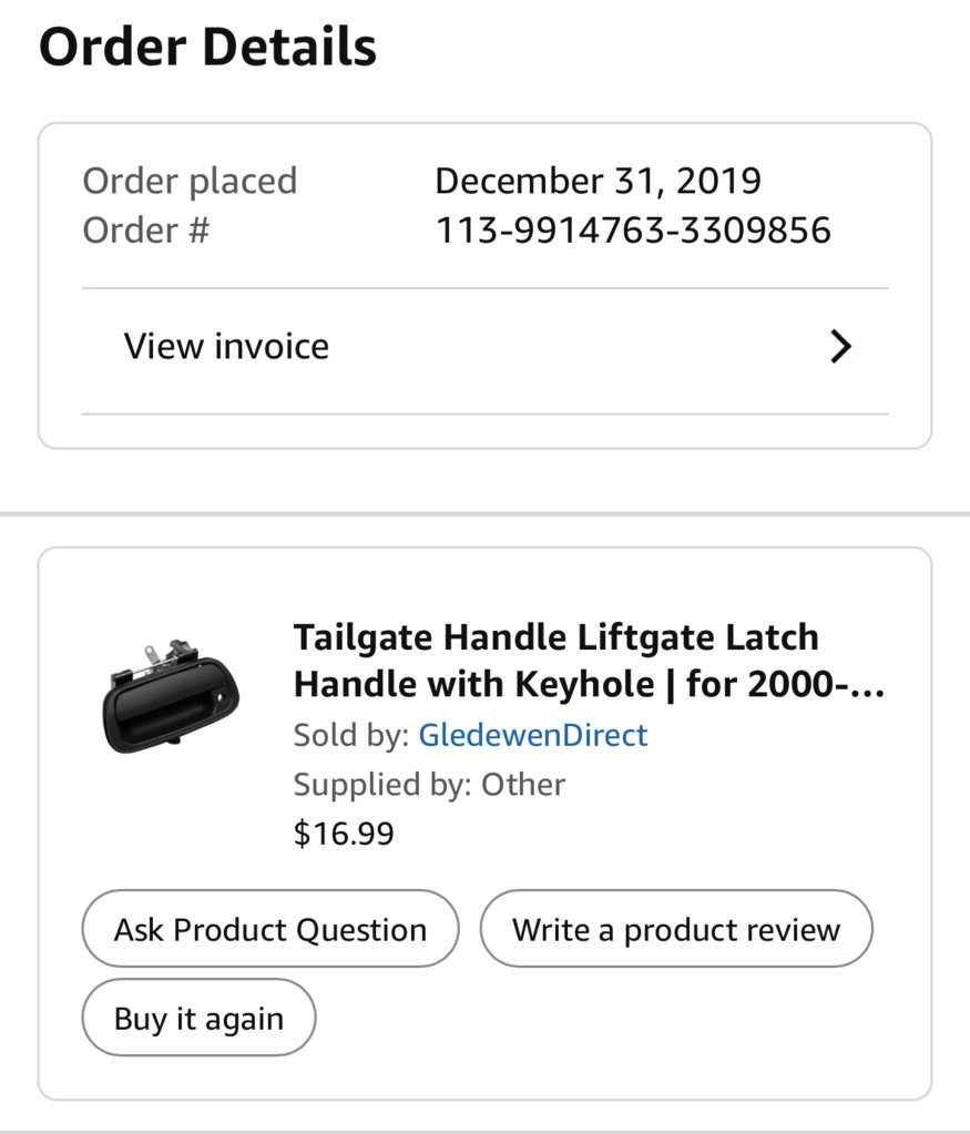

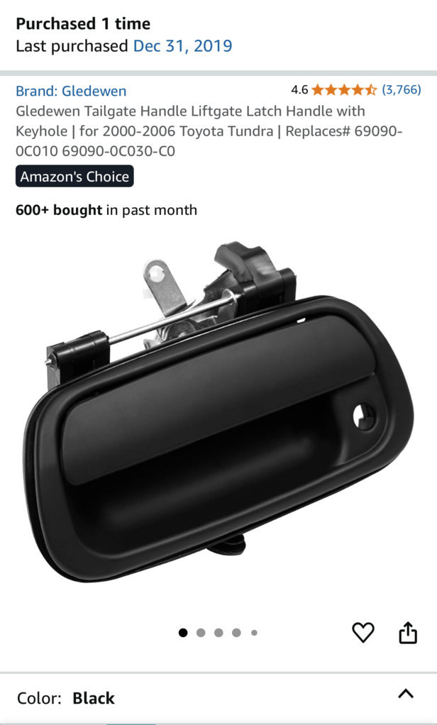

    I too bought this camera; reviews tomorrow I hope...

    I forgot to reply when I saw this. Mine did what 3.4tundra's did. Frame cracked but the handle still worked.
