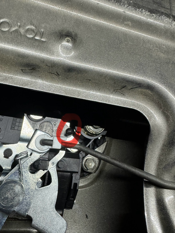

    Is it possible the latch is in the lock position ?

    Flip the lever/ nipple in the opposite direction

    This has been an issue in the past for another member or two. Ended up just being locked.
    vercetti[OP] likes this.

    so yeah that did work, but my main issue still persists and i probably made it worse. i put the tailgate back on and it still would not latch on. now the issue is that i used force to push it in and one side somehow went in and the other halfway but no fully. but now my tailgate wont open at all. not even in full force. didnt even get to strap on the wire handle things because i wasn’t expecting for it to get stuck.

    First off, on the latch. Did you go with OEM or the cheapest shit you could find on scAmazon? It makes a difference. Cheap shit is cheap for a reason. Many of the guys on here who bought cheap latches on scAmazon had them fail within a few months or year or two, only to buy another latch, and repeat 3-4 times until they've spent more than they would buying OEM.
    Second, it looks like the latches are frozen and could probably use some PB blaster, repeated soaks, just to free them up. On the latch that won't catch (passenger side?) what happens if you unhook the rod at the handle (purple clip), and manually pull the rod towards the driver side tail light? Does it unlatch? If so, the new tailgate handle is your problem. If should be doing a "twist" sort of movement where it pulls the driver side latch's bar toward passenger side, and the passenger side latch's bar toward the driver's side, which is what lets the latch loose.

    so all i bought was the handle new from ebay, cheap one. the little lock thing you mentioned worked perfectly for it. i never bought new latches. the tailgate has the original latches and yeah they looked like they had better days. i also bought the hooks that go on the bed where the latches go. i could tell from the old ones that they had rusted off broken because all i found was 2 spikes on each side where there was supposed to be hooks.
    i sprayed pb blaster but no joy. now im hoping it doesnt open while im driving as i couldnt even connect the retention wires. im guessing im gonna have to get on it and kick off the latches off the hooks?

    forgot to mention that the latches (the hooks on both far ends of the bedrhat attach to the bed hooks) did not move when pulling the new handle locked or unlocked. only the rods and the inside latch mechanism where the rods latch on would move, the latches that lock in to the hooks would not move.

    Yeah, saw that in the video, and it's why I said it appears the tailgate latches are frozen solid. Not the catch inside the latch, that does move as it should it seems, but the mechanism of the latch itself that's supposed to trigger the catch, it doesn't appear to be moving. Frozen tight.

    thats my conclusion at this point. tho pushing it in did make the latches move to the point where one locked and the other didnt. now the mission is how to open the latch.
