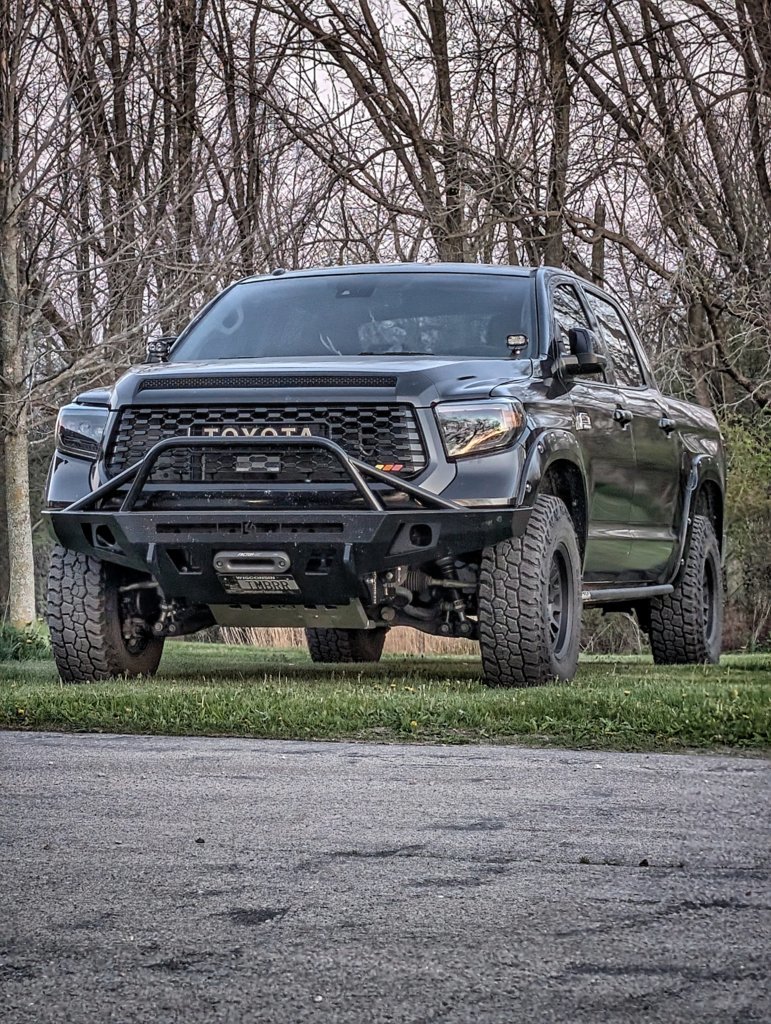

    Thanks for tuning in!
    Current picture:
    Feb 12th, 2025 clocks 10 days since I picked up my new Tundra (90k on the clock) and I'm excited to document my build not only for my personal reasons, but in the hope it sparks some ideas for other Tundra owners down the road.
    I flew down to Texas as some Midwesterners do for our vehicles - to find a clean vehicle that our lovely salt brine hasn't touched yet. After a couple months, I found the one.
    From a mile away, it looks clean, stock, like any 2020 1794 would...PXL_20250202_204159239.jpg PXL_20250202_215825308.jpg
    But when you factor in this is what the truck looked like a year ago... You can see where this thread is going to get interesting.:kona:
