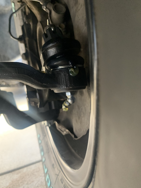

    One side of mine is moog, the other is unbranded. The moog one leaks. Still seems tight and no issues so I just grease it every once in a while.
