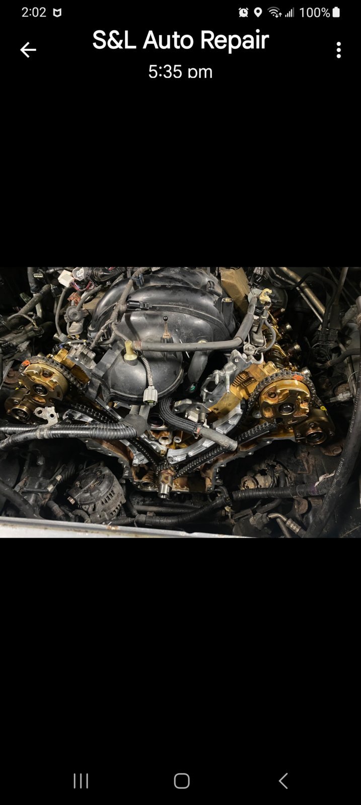

    Hi All..
    Bought a 2012 Tundra 5.7L w 135k miles in Feb 2023. No rust no accidents. Locally owned truck, not auctioned Around the country. Was CPO around 2018. Dealer serviced since new. Have full documentation. NO previous P0 codes etc. Metallic silver. Around 2 months later, timing chain noise on cold start. Got slightly worse and worse. 139k miles now. Mechanic was told to use OEM Toyota parts. I had him verify by showing me parts. But hope it's not knockoff parts. Accessory belt tensioner bolt frozen. Radiator and water pump and tstat was replaced by previous owner 2 years ago. Mechanic found leaking coolant t-hose front of motor under intake manifold. A small bit of oil seepage in valve covers. NO CAM Tower Leaks. Oil had UV dye mixed in. Truck was $17300 OTD. This makes it a $21k used Tundra. I hope it was an OK buy(?) First and only Toyota. I thought they are reliable?? Pic #2 shows the small pink popcorn coolant leaking just und we the intake front. The pic 1st pic is old timing chain passenger bank. Can see the chain slop from the 1st pic. The rest of the pics shows the new chains, new tensioners L and R.
    Please enjoy the pics...

    quikz,
    I'm no stranger to Toyotas. A plastic timing chain guide in the 22R/RE was the nemesis of Toyota in the 80's.
    I've owned and replaced many of them with metal-backed guides, which triples engine life expectation.
    I also just bought a Tundra (two days ago) and I'm thrilled with your PICs, which show factory metal-backed chain guides.
    Perhaps the water pump replacement didn't go smoothly: put a bolt in the wrong hole locking up the tensioner - a common mech error on the 22R/RE.
    Your fix is very likely to cure what ails, after which you'll enjoy many happy miles of Tundra ownership.

    Thanks for your reply. My mechanic said my passenger side tensioner was faulty as I recall. But will ask again. He is giving me back the old chain tensioners etc and I will analyze. Toyota updated the tensioner 's oil ports I believe maybe 3 times(?) By enlarging them I think. Anyway, the new chains are on and it's tight now. I personally believe these chains are TOO whimpy, along with poor tensioner design. Chains should have been made at least 20% beefier. Will post tensioner parts as I forgot to retrieve them last time...

    Here are the pics of the old 2012 5.7 tensioners, guides etc, mileage 139k. Plus mechanic said one of the VVT solenoids was bad, drivers side bank. Grand cash total plus new spark plugs and a tire rotation = $3700.
