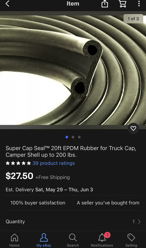

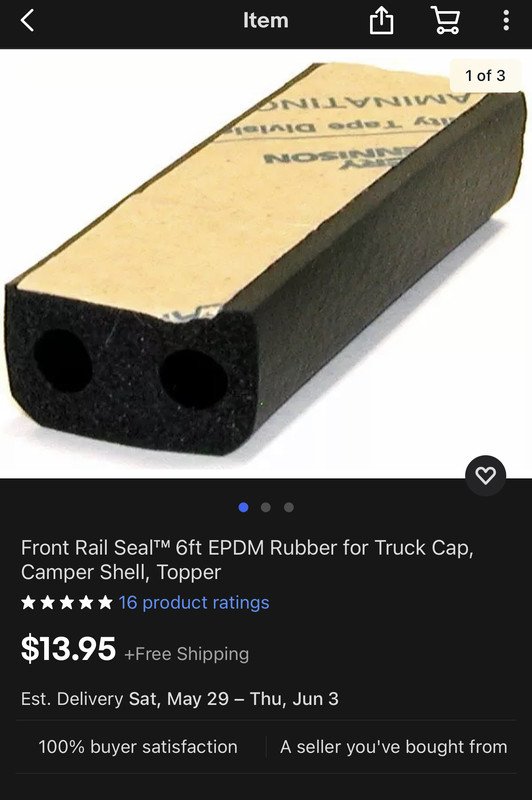

    I bought these seals to help water proof as I use it for camping too. It does leak a little when I go through the car wash but standard rain doesn’t seem to be an issue.
    Seal for side rails:
    https://www.ebay.com/itm/Super-Cap-...-Cap-Camper-Shell-up-to-200-lbs-/321511977294
    Seal for front bed rail:
    https://www.ebay.com/itm/Front-Rail...r-Truck-Cap-Camper-Shell-Topper-/321360576249
