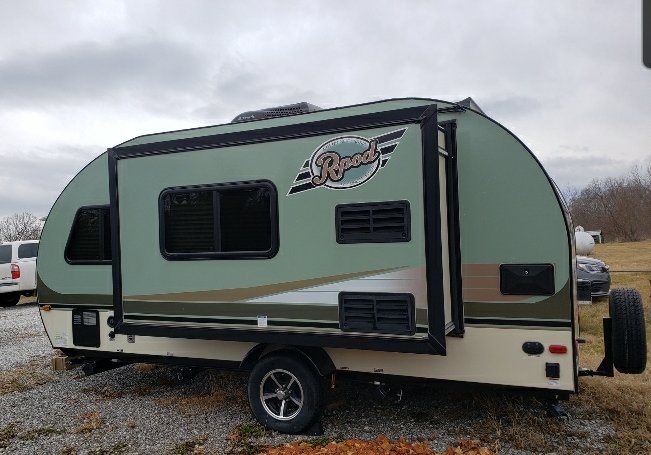

    I have a 2017 rpod 179 for sale if anyone is interested.
