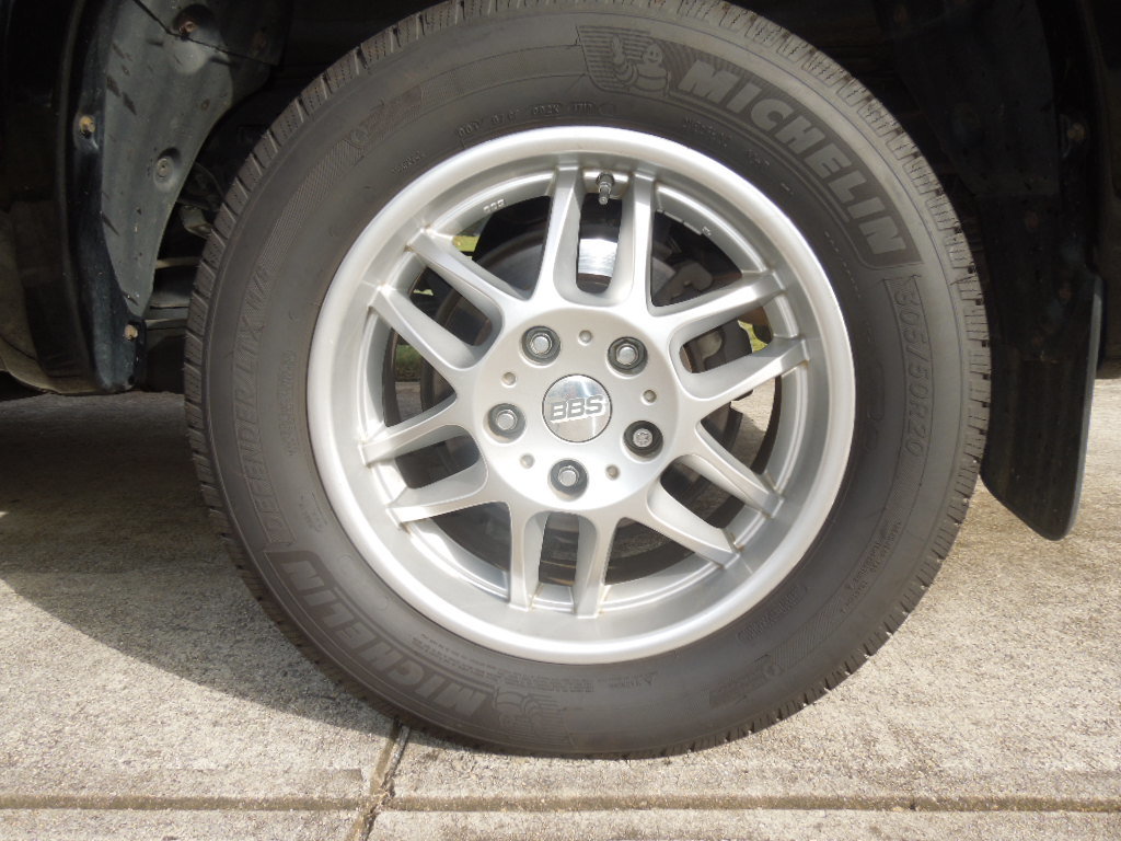

    2007 Toyota Tundra. Purchased used 8 years ago with BBS wheels and 305/50/R20 tires on it. No problems. TPMS light came on this year. Owner's Manual instructions do not work. Replaced bad TPMS sensor in driver front wheel with aftermarket. No joy. Replaced all 4 TPMS sensors with Toyota OEM # 42607-0C070. Discount Tire said all 4 new sensors work but the sensor light still stays on. I've tried resetting the system using the instructions in the owner's manual and the button under the dash. The instructions state turn it from Off or ACC to On, and then hold the button until the TPMS light blinks slowly 3 times, and then wait 7 minutes before turning it to the Off position. As soon as I turn the ignition On the TPMS light starts blinking and then turns solid after 1 minute. It does not blink slowly 3 times so it never goes into the calibrate mode for 7 minutes. Any insight?
