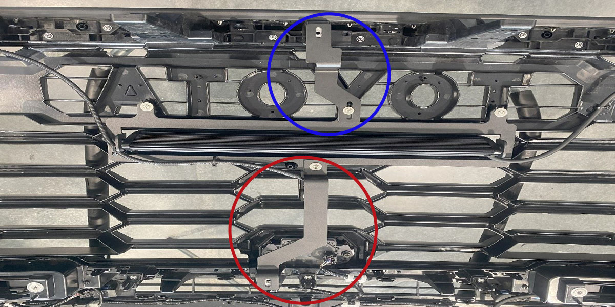

    I installed the TRD Grill on my SR5. Seemed easy. I don't have a camera in that little hole - but that's fine. I installed the Diode Dynamics Light Bar and bracket. Seems like a nice piece.
    Holy cow. I can't drive on a country road with that light on. The grill has so much flex - the light is flashing up and down off the road. You can see the beam of light jump and shake with every bump. Sky, road, sky road, sky, road.
    So... I hop out... and tap on the grill. No Shit. That plastic grill has zero support and just vibrates and wiggles and dances.
    Am i the only one?
    I guess I can build a strut that comes out from the Radiator Flappy Thing and supports the grill where the Camera goes...?

    Did you install the upper and lower brackets as well, or just the side brackets? Mine has some flex but definitely not jumping all around like described

    Its not the grille's fault...its that cheap pos kit DD sells without a proper support bracket. My baja designs light bar is SOLID.
    Did your kit from with the upper and lower brackets or just the light bar surround?

    I guess I don't know... What brackets? I feel like I'm missing something.

    I'll have to crawl under there and look!
    Thank you for the photo!!

    I'll add one more thing...these brackets do not take the weight off the grille...they simply help distribute it. Those mounting points they use are for the grill shutters which are directly attached to the grille. Baja Designs and Westcott both use similar brackets but they attach to the truck itself and thus do not rely on the grille to support the weight. DD just went the cheap route and provided a janky little bracket. You bought the wrong kit :)
    And no need to get under the truck...you can take a look from above

    the brackets were included in my kit I got from Black Friday and were somewhat recent to that sale to be included. If you installed in earlier part of year, chances are you may not have the updated brackets.
    To both Eddie and my point earlier, you still have some level of light bounce due to where those brackets mount to. An actual frame mount would have been much better to eliminate it but you get what you pay for and all.

    exactly...theres a reason why Jeff's brackets alone are $200+. I actually think this is a superior mounting solution than BD's. Jeff mentioned that they noticed grilles fracturing when submitting them to continuous vibration w/o a bracket and thats why he designed this setup. Everyone else followed suit to match their price point.

    Older kits didn’t come with them. Newer ones do. If yours didn’t email them and they’ll send it out. Made a big difference.

    Same issue with my Heritic mount. Reached out to them and they sent out free of charge a new updated mount.

    No - my kit did not come with any additional brackets. I bought the kit from Diode Dynamics over a year ago.
    Is the Westcott Kit superior? Would the Westcott mount fit my current DD Light Bar? Maybe that's my solution...

    You can email diode dynamics and they’ll send their new brackets for free

    Westcott kit is the best one out there and fits 20" bars...notice how it has the little < > wings on the ends of the opening to blend into the grille...very nice little touch. I'd call them and ask for the dimensions and compare to your DD bar
