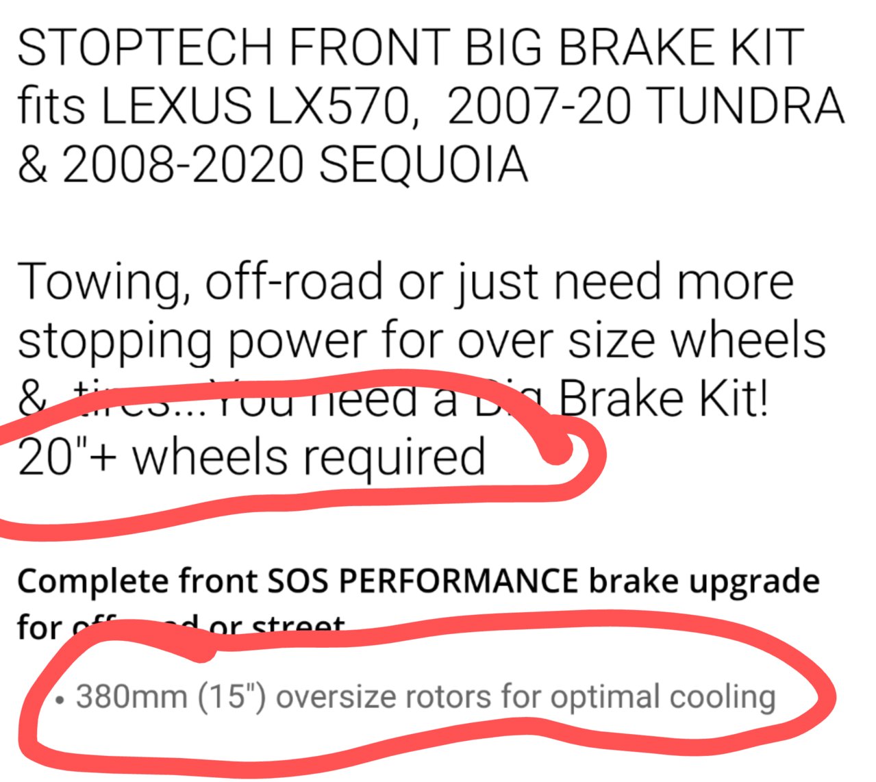

    I have the BBK on my 17' and no issues other than your wheel choice must have the room! OEM wheel fit with 3/16" clearance.
    If I were to buy anything else it would be the Stoptech BBK ( they actually made TRD BBK and make both a front and rear option of their own). Brembo is the most expensive, but you get what you pay for.
    https://sosperformance.com/t/stoptech
    This is TRD BBK equivalent: (front only)
    https://sosperformance.com/products/6-piston-front-big-brake-kit-fits-2007-2017-toyota-tundra
    They work fantastic!
    The pad dust is a bit more than stock too.
    And make sure you brake them in properly, the break-in is very important to avoid having any shudder or hot spots on the rotors.
    SAN DOG 34 and TheBeast like this.

    2020 TRDPro CM MGM, 2018 LC200 MGM
    what size wheels? Are you saying they fit under the oem 18" bbs??

    NO.
    If you read the specs, any of the true Big brake kits have up to 380mm rotors and require 20" rims minimally. Some 20" rims do not even fit. Anything 18" WILL NOT FIT for a true BBK. TRD or aftermarket. There are "upgraded" kits that the 18" wheel fits, but they are not bigger.

    Gotcha, confused me when you said oem wheels fit with 3/16"clearance
