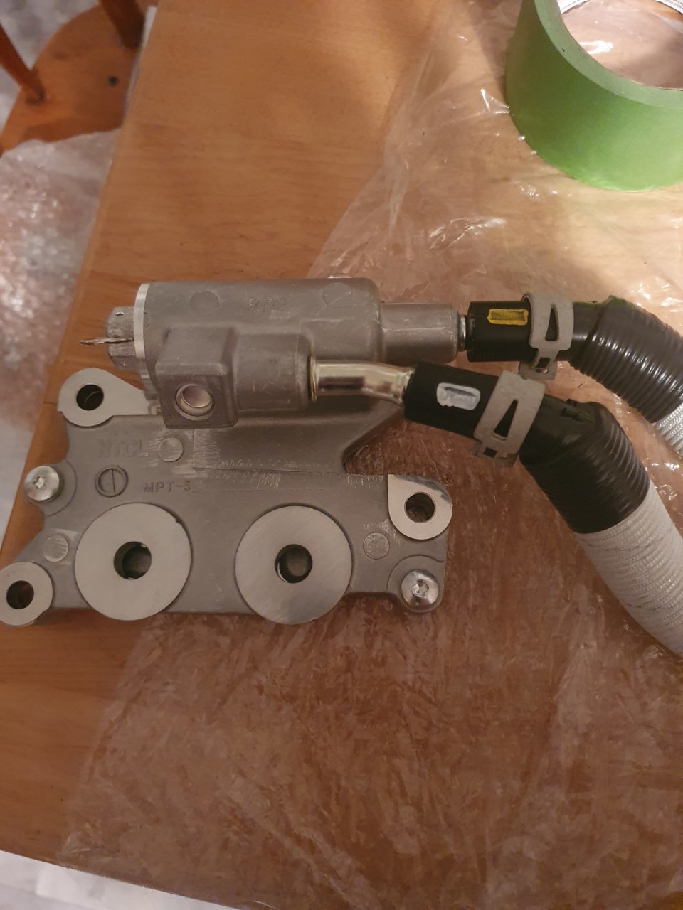

    Is it a cooler thermostat in the classic sense-running trans fluid- or a coolant thermostat that runs coolant through it to heat/'cool' the transmission fluid?

    A 2015 Ltd should have the tow package which included an auxiliary cooler - not just the puck that’s on the 2019-2021. It has a button that gets pinned down to force it open allowing flow through the whole system while cold.

    Do they look similar?

    All Tundras have the puck that brings coolant to the transmission to warm the fluid, the difference would be you would see a thermostat with lines attached running to the front of the truck if you have a cooler. This is what the thermostat looks like, it would be attached to the transmission and then the warming puck is attached to this, on 2019-2021 there is a spacer to take the place of the thermostat.

    Ok. So the warmer puck that's on all trucks just warms the trans fluid via coolant and I assume 'cools' when the trans fluid gets hotter than the coolant is?

    Correct, just it does a very poor job at it and if you monitor your trans temps you wont ever really see it go down once it goes up it basically stays up until you stop driving.
