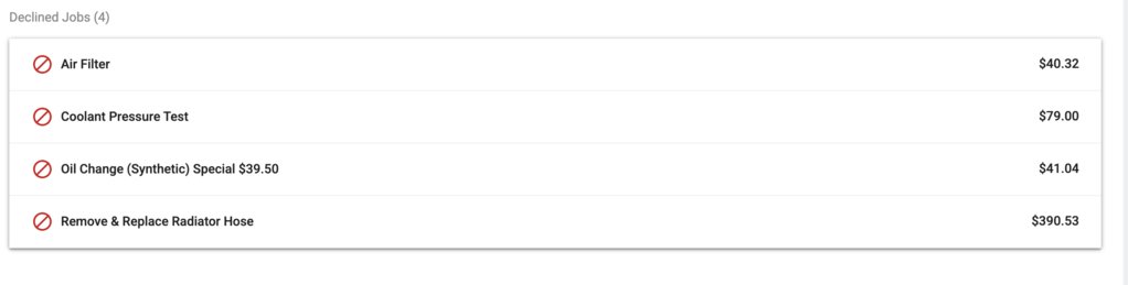

    So I ordered the part and clamps. I was going to do it myself but since im getting an oil change I figured I would ask how much extra it would cost to have them do it. They quoted me at $110 saying it would take an hour to bleed the system so there’s no air pockets. I declined.
    my question is this necessary and if so how do you do that? I thought all I had to do was open the drain cock to remove maybe a half gallon. Remove and replace upper hose. Top off coolant and run engine. Top off again.
