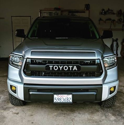

    Any threads on that truck in the pic??

    Per your request.
