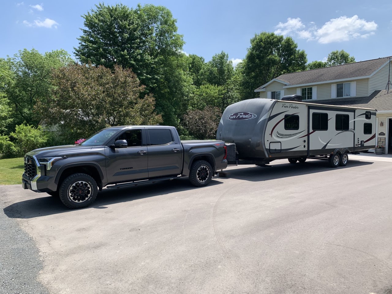

    IMG_4842.jpg IMG_4841.jpg I am hooking up the camper for the first time this year after adding a 1.75” front/1” rear lift.
    Ground to bottom of fender measurements front/rear:
    Unloaded 39.25”/40”
    Hooked up no WDH 40.5”/37”
    Hooked up w WDH 39.5”/38.5”
    Using a 12,000 lb hitch wit h 1200 lb arms. Camper is about 7000lbs with 7-800lbs on tongue.
    Thoughts? I’d appreciate advice. Pics are WDH arms on and no arms.

    Definitely need the WDB keep them on,your truck doesn't squat as bad with them as you know you'll have better road control when a 18 wheeler blows by ya,the vacuum won't be as bad.

    Is anybody a hauling expert? Are the squat measurements ok? It seems ok with the arms on with a 1.5” drop in the rear and the front as is.

    Hey nice trailer! I’ve got a 2/1 lift and have about the same squat as you with my WDH. Our trailer is a bit lighter

    Do the same comparison at a CAT scale and the numbers will amaze you. Looking at your measurements, it/s the front height that tells a lot. With the WDH on you are basically back to normal height, which is what you want to maintain steering and control.

    Measurements are good but if you could bring the front closer to 39.25” it’s better. You want to get the front as close to unloaded as possible to keep good weight over the steer axle. Lighter bars have more fidelity in adjusting the weight distribution when adding chain links.
