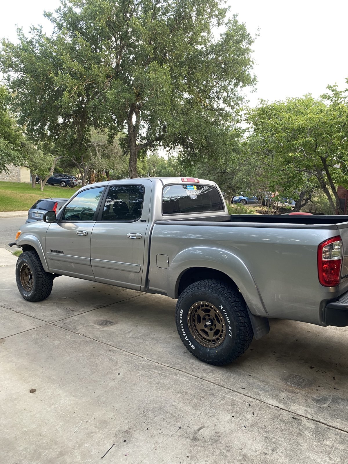

    Have used 5100s before but now running 33s with 2.5-3" lift up front from adjustable Eibach shocks for under $250 with OE springs and leveled in back using AAL. Probably like $500 in parts with today's money.
    https://www.tundras.com/threads/2-5-lift-on-1st-gen.140326/#post-3536140
