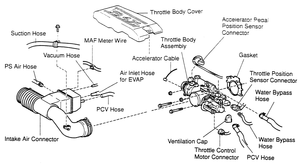

    So I've been trying to find something, but I'm not really finding anything definitive. I'm seeing applications where it's capped off like what your seeing:
    But I'm also seeing applications where it has a hose connected, but isn't really indicating where it goes:
    Based on the second image, I might venture a guess that it may go to where this image suggests is the PCV Hose (on the left side of the image at the air intake):
    It's also possible that it's something that's not used in your application, or is something that is just not used due to a possible difference in California vs. Federal emissions requirements on a version of the throttle body from earlier model year vehicles, like an earlier Land Cruiser which has also used the same engine.
    If it's running fine, I would think that you're okay to leave it be as is. If it were to be connected to the air intake and isn't, I would think it would set a CEL, unless the speculative "other end" is capped too.
    I did learn that the connected hose on the driver's side is likely connected to Vacuum Switching Valve (VSV).
