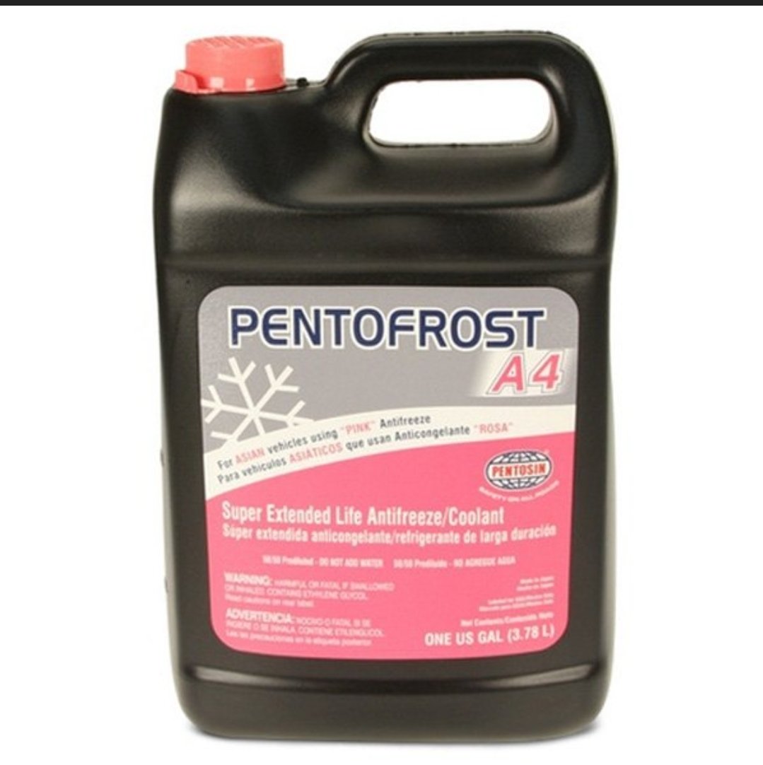

    pman9003
    pman9003 New Member
    May 13, 2020
    #46504
    197
    ATL
    2020 Platinum 4x4
    Rocko9999 likes this.
