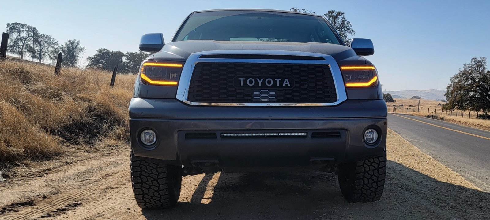

    Here's a few pics from my drive out to the country today.

    Lookin good
