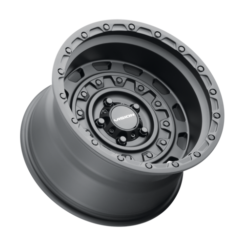

    Got an appointment Wed for tires, 2wd here:
    MICHELIN DEFENDER LTX M/S2 275-60 20R
    On these rims(I'm older 'n dirt and don't like things just because they're trendy, lol):
    VISION
    TACTICAL
    20 X9.5 5-150.00 12 BKMTXX
