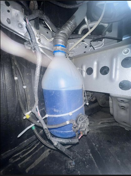

  18. Jan 23, 2024 at 6:13 PM
    FishNinja
    FishNinja HIDE YOUR DAUGHTERS
    Jan 3, 2024
    #109562
    2,181
    Lee
    TEXAN....big surprise
    06DC2wd
  19. Jan 23, 2024 at 6:21 PM
    bfunke
    bfunke Tundra Curmudgeon
    Oct 13, 2019
    #37321
    2,391
    South Carolina
    2018 SR-5 CM 5.7, 2000 SR-5 AC 4.7L
    I was thinking the grommet where the pump plugs in could be a leaker as well.
  20. Jan 23, 2024 at 8:12 PM
    66chevelle
    66chevelle [OP] New Member
    Jan 13, 2024
    #110203
    10
    Galen
    05 dc tundra rwd
    It’s definitely where the neck connects to the reservoir. The local Toyota dealer had the neck piece for $122 but couldn’t tell me if the grommet was attached to the neck or the reservoir. Took shiftys advice and ordered the entire assembly from Dorman for $140. They only had 4 left in case you need one.

    this would be even better if he made a quick disconnect/connect. So he could just swap out bottles.
