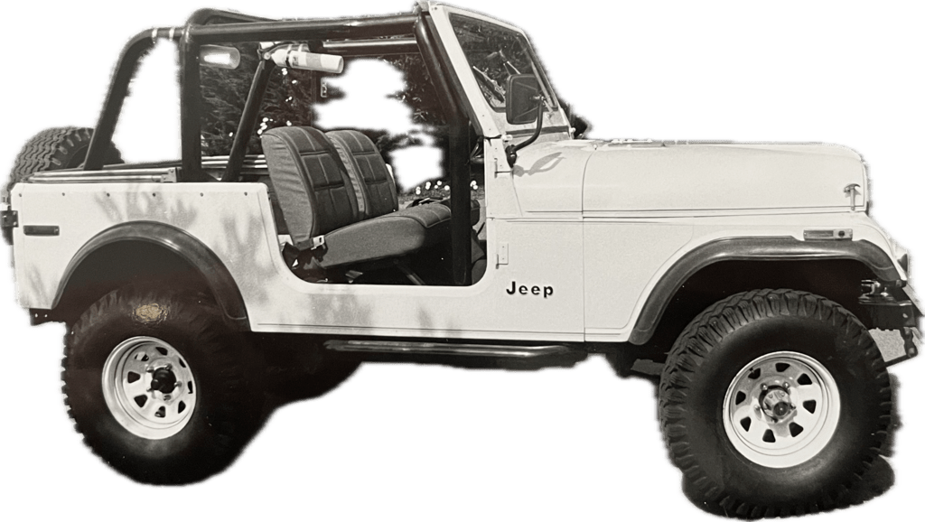

    Cool! I had an ‘80 CJ7. With a built 304ci.V8. My first 4x4. Loved it and miss it. .. but not the 10mpg!!

    Very nice. I had a '79 CJ5 with the 304. I sold that one to buy my Father's '81 CJ7 because it was in better shape, and I liked the extra room in the CJ7. I quickly learned that the 258 I6 in Dad's Jeep was a dog compared to the 304.
    It took me 30 years to get around to restoring Dad's '81. But I finally got a V8 in her (AMC 360).
    Now, she's mostly a garage queen. I take her out on nice days for nostalgic sake. I should find some kid who would really enjoy it, but I just can't let it go, yet.
