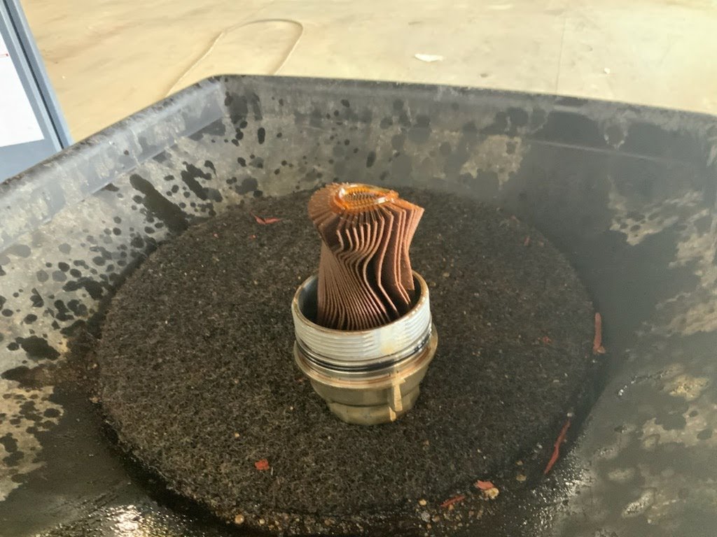

    I brought my Tundra 5.7 to the local Toyota dealership and they removed the oil suction tube when they changed my oil. About 2000 miles later I got a P0012 code bank #1 and #2. I had to get home and put about 500 miles on it with the check engine light on. Found out the filter hadcollapsed because they removed the tube. Should Ibe concerned about damage to my engine?

    What did your oil pressure gauge show while CEL was on?

    OK. Here is the question that I have for the Toyota folks out there. The dealership finds that their technician messed up and removed the suction tube when changing my oil. I get a P012 code that results from the oil filter collapsing and restricting oil flow. Oil is bypassing the filter as well as being restricted. The head technician finds the problem and replaces the tube and installs a new filter. He adds two quarts of oil and closes the service order. According to Toyota, this code indicates restricted oil flow or oil contamination. (See attached photo of the filter). There is over 2500 miles on this oil change. I asked the technician why he didn’t just drain the remaining six quarts of oil as long as he had everything right in front of him. Judging by the tone of his voice he wasn’t happy that I asked him. I was concerned about the remaining oil. He said he inspected the oil for debris and it was good. Even if everything was fine, why not just change the remaining oil to make up for all the trouble they put me through? Now I’m concerned about the possibility of running contaminated oil so I am going to do an oil change. I have reservations about this dealership. Am I being unreasonable?

    I for one certainly don't think it was unreasonable to ask for an oil change while it was in there, especially since they screwed up. Did they give you an explanation to why the Tech removed the tube in the first place?

    Well just change the oil then and hope that all those miles with the filter being compressed like that didn't cause any harm to your engine, what else can you do?
