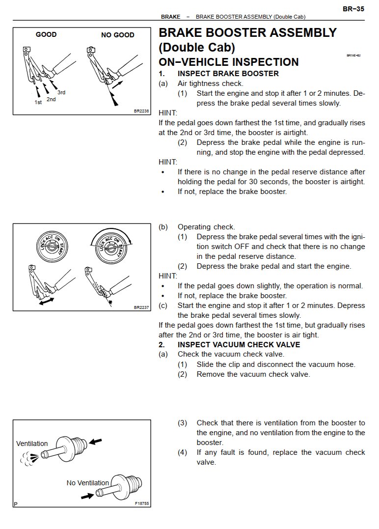

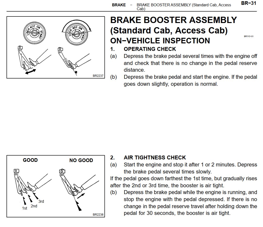

    Sure, it could be the booster, but there's a test for that in the FSM, it's been posted here a few times.

    Test the booster per FSM. If it checks out per FSM, then …

    Also curious about something.
    You say pushing the pedal down multiple times builds up pressure. How long does it take before you LOSE pressure again?
    Have you checked the vacuum line from the manifold to the check valve on the booster? Sprayed soapy water all around it, and around the seal between the MC and the booster, then charged up the brakes by pushing the pedal several times with the engine running to see if there are any bubbles or signs of unexpected inflow/outflow?

    (Also, for double cab guys who may read this)
