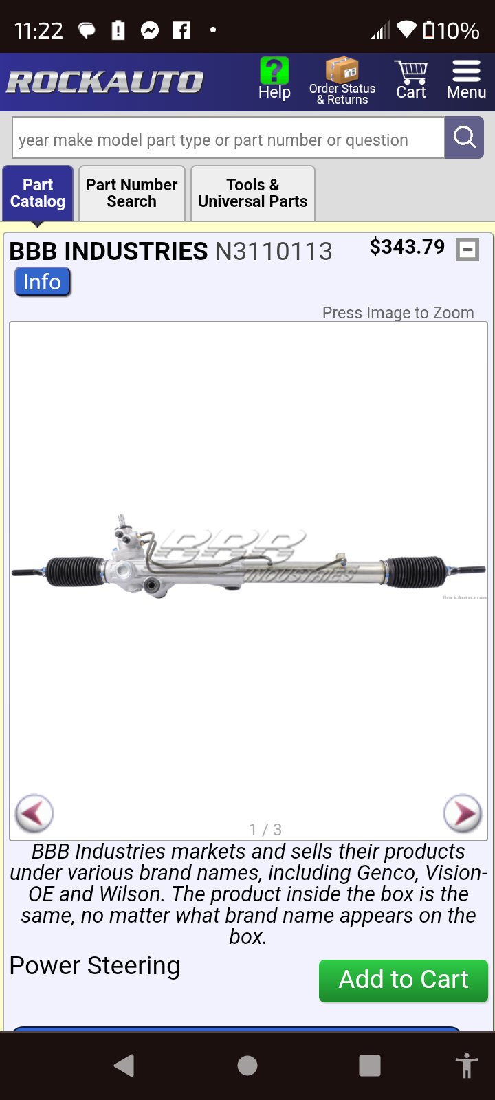

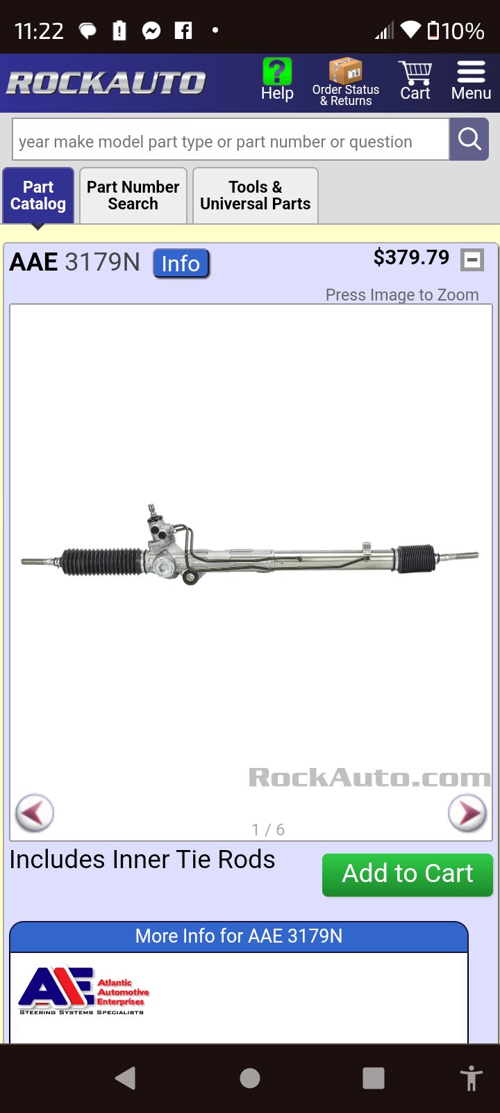

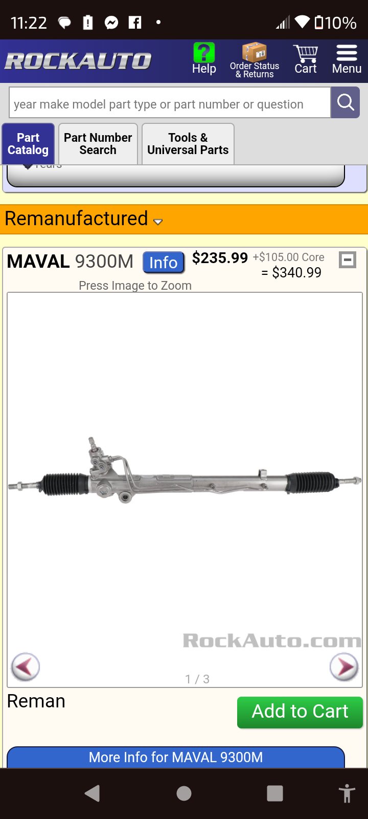

    Which rack would you guys choose? I'm thinking about getting a rebuild kit too and see if I can't do while something else is on the truck Screenshot_20240423-232246.png Screenshot_20240423-232246.png Screenshot_20240423-232234.png Screenshot_20240423-232215.png

    OEM or reman OEM. I have to assume your truck and 100,000+miles on it. The OEM lasted this long. Why mess around with something that you might end up having to replace in a couple of years?

    It sounds like from others' experience on here, OEM is made by Jtekt.
    @bmf4069 had his Detroit Axle unit for a while and beat the hell out of it and it's still going, but then again, average non-OEM parts typically only last 2-5 years hence why they cost less. You don't want to do the install twice.
    I don't see any brands in your list I'd necessarily trust.
