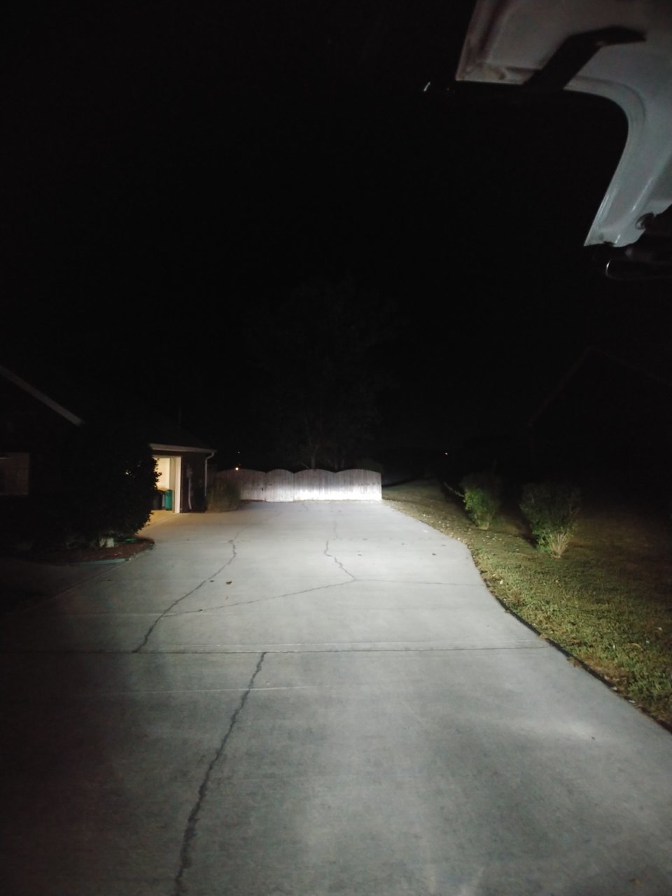

    I saw your post yesterday and was glad you made the choice. Glad they are working for you. Would love to see an equal distance comparison before and after shot to give us apple to apples.
    The low beams are solid as you say. High beams are not the best and seem to be almost like a spot light type concentration which I noted as well in my review. I rarely ever high beam and if I do its for a brief time and for long range viewing. High beam was not a deal killer. Sadly, no adjustment can be made on the high beam.
    The low beam is very nice and did adjust the angle down at first, but have made slow adjustments up to previous range in small increments to see how other drivers would react. So far zero flashbacks.
    Side note: During daylight hours people seem to stare at the light as if mesmerized by the headlights as I drive past them. Also, people seem to pull out in front of me more often than before. Just weird antidotal observations.

    When the weather is gloomy and overcast I will put my lights on and I seem to have more people pull out in front of me. No idea why this is. I'm sure the white, black, and grey cars, that never turn their lights on in bad weather never get anybody pulling out in front of them.

    Have you been flashed at all since the switch? I was driving around 0200 Sunday at had 2 different drivers flash their high beams at me. That was the first time since I made the switch.
