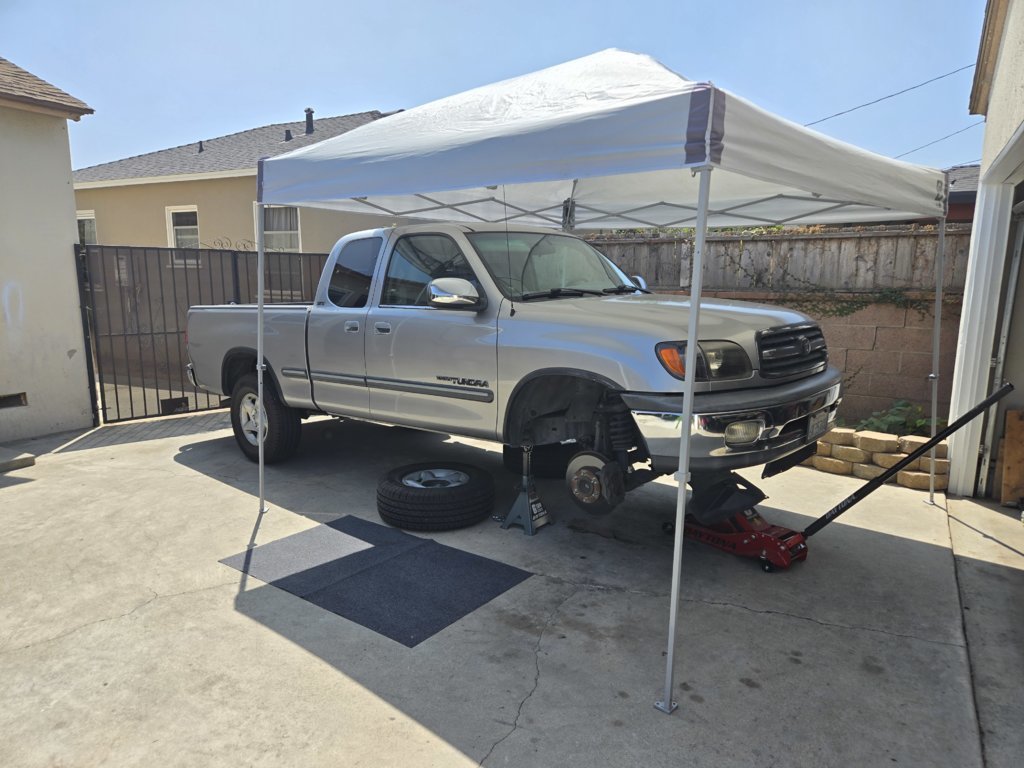

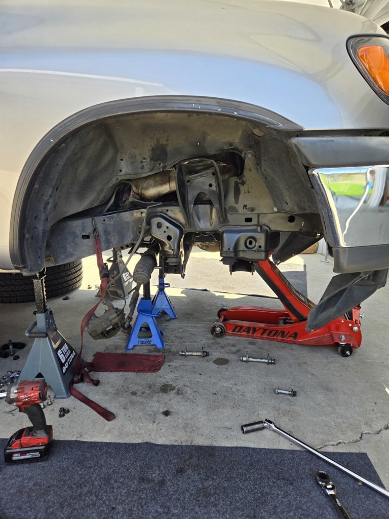

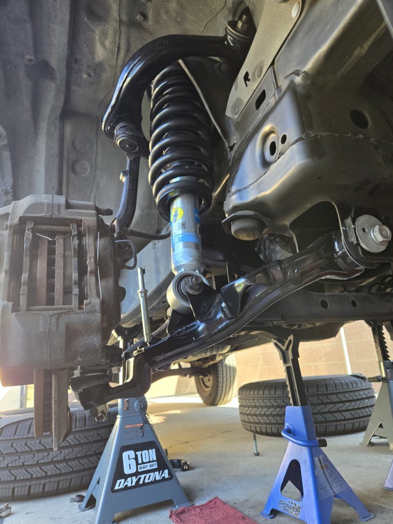

    Stupid Q, but you did unhook the swaybar links before lifting the truck to do this work, right? If not, unhook them. Then, step down on the lower control arm and put some weight into it so it'll drop. The LCA will flex downward to an extent, and it should give you the oomhp you need, but not is the swaybar is holding things back.
    Will do, need a bit. Heading out on a hike with the oldest. Will try to snap a pic on our way out.
    It's more about the overall size. I'm not expecting it to do the zerks on the front driveline too easily, they're in weird ass places and hard to get to even with a straight, skinny tip. That lever on the lock-and-load is unweildy, wide, large.

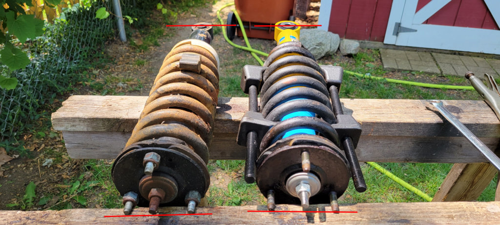

    When I did my front shock replacement (2000 AC) I made a mental note of how the lower mount was "clocked" in relation to the upper 3 mounting bolts, see picture.
    I had one that lined up perfect, and the other maybe 3 degrees off, but easily twisted a little.
    I think that's what you are saying, that you get the assembled strut in there and the lower mount is twisted, not aligned.
    Definitely unhook your sway bar links like suggested as well. I would try to do it w/o loosening your cam-bolts.
    But if you have to, mark where they are first, then make sure the truck is fully resting on them before tightening back up.

    To this point, if it's just a matter of aligning the bottom, pop a long shank screwdriver in the mount hole of the shock and rotate. You can, to a degree, spin them. Not a huge problem for fine adjustments.
