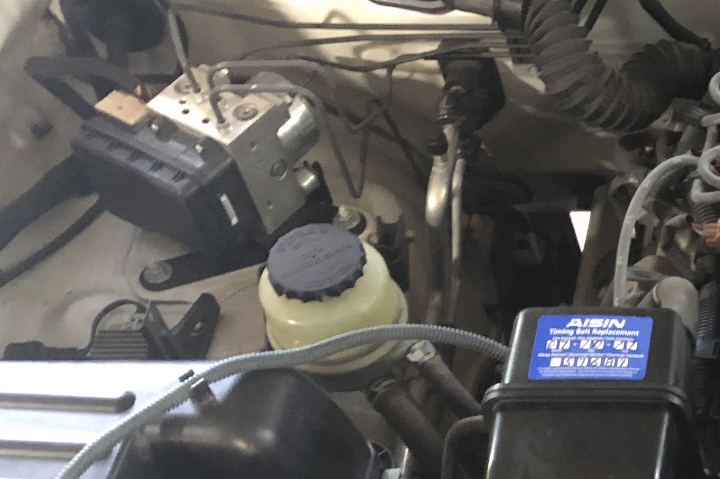

    Isn’t it nasty? The PS fluid has gotten so hot so many times that the whole reservoir is dark and gross.
    I have a new-used OEM pump and reservoir from a truck with like 40k miles. Scored them for like $45- I’ll be putting them on soon.
    Ace Pickup Parts, a dismantler in California, got a 40k mile FGT about a year ago. I’ve bought a bunch of used OEM parts from that truck, from them, at good prices.

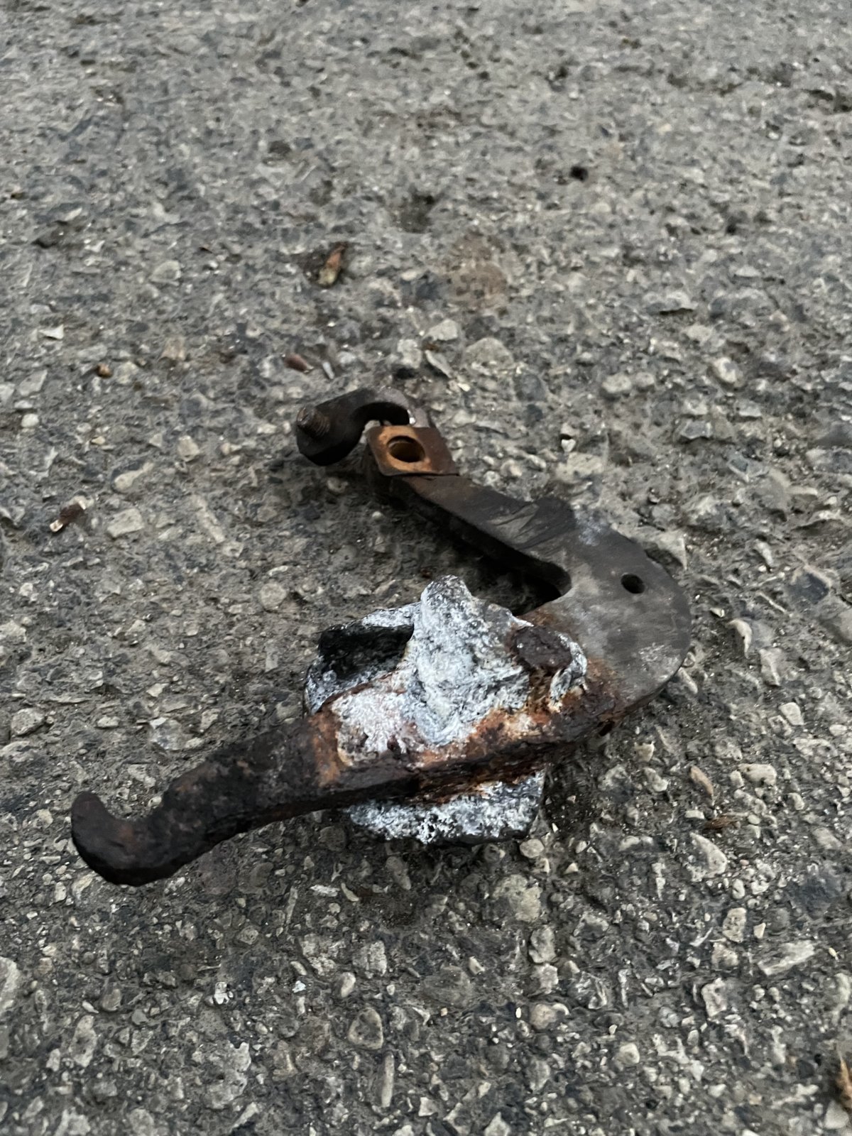

    Big update!

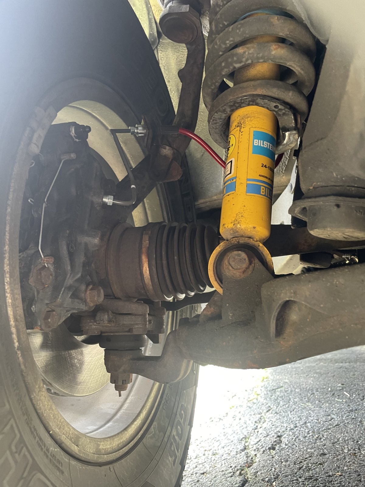

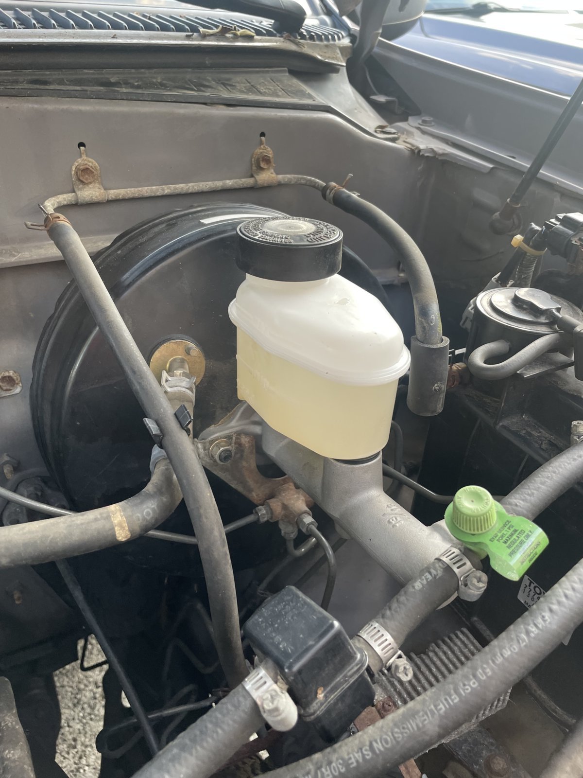

    The master cylinder started leaking fluid into the booster, and fast. It would dump everything in the reservoir in less than 10 miles. So I decided to replace everything. Like, everything.
    The rotors/pads and drums/shoes got replaced, but I also threw on new stainless steel soft lines, new caliper hard lines, new drum hardware, parking brake cable, new parking brake bellcranks, the works. It was a little bit of a debacle to get it all to work but they’re solid now. Feels nice to have a firm pedal and clean fluid in the reservoir.
    It was also really really nice to be able to use all new parts and hardware during reassembly- there were so so many parts that were beyond saving. The old bellcranks look like they came off the titanic:

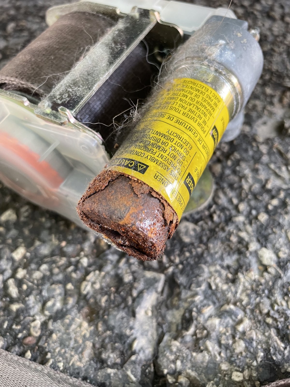

    About a year ago, I got the airbag light diagnosed at a shop. I finally got around to replacing the seatbelt pretensioner that was bad. The old one was definitely no good:
    But after I replaced it, the airbag light is still on. And not just on constantly, blinking constantly, like before. Not sure if the light needs to be reset, or if the code needs to be cleared, or what. The truck is going to the mechanic in August to get a bunch of stuff done, I’ll tell them to take a look at it.

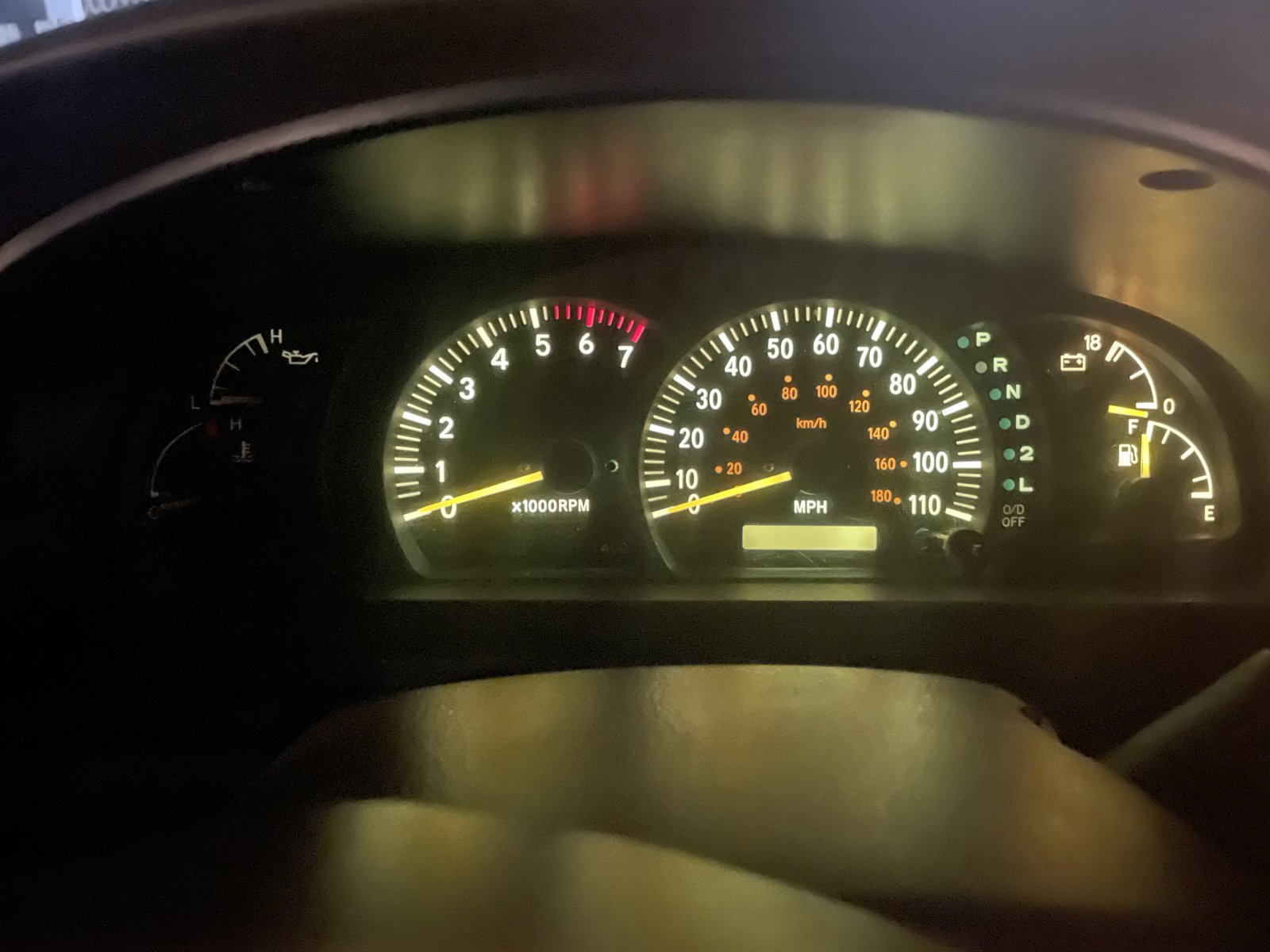

    Cluster lights burned out again. Successfully removed the green rubber grommet from the old bulb without tearing it.

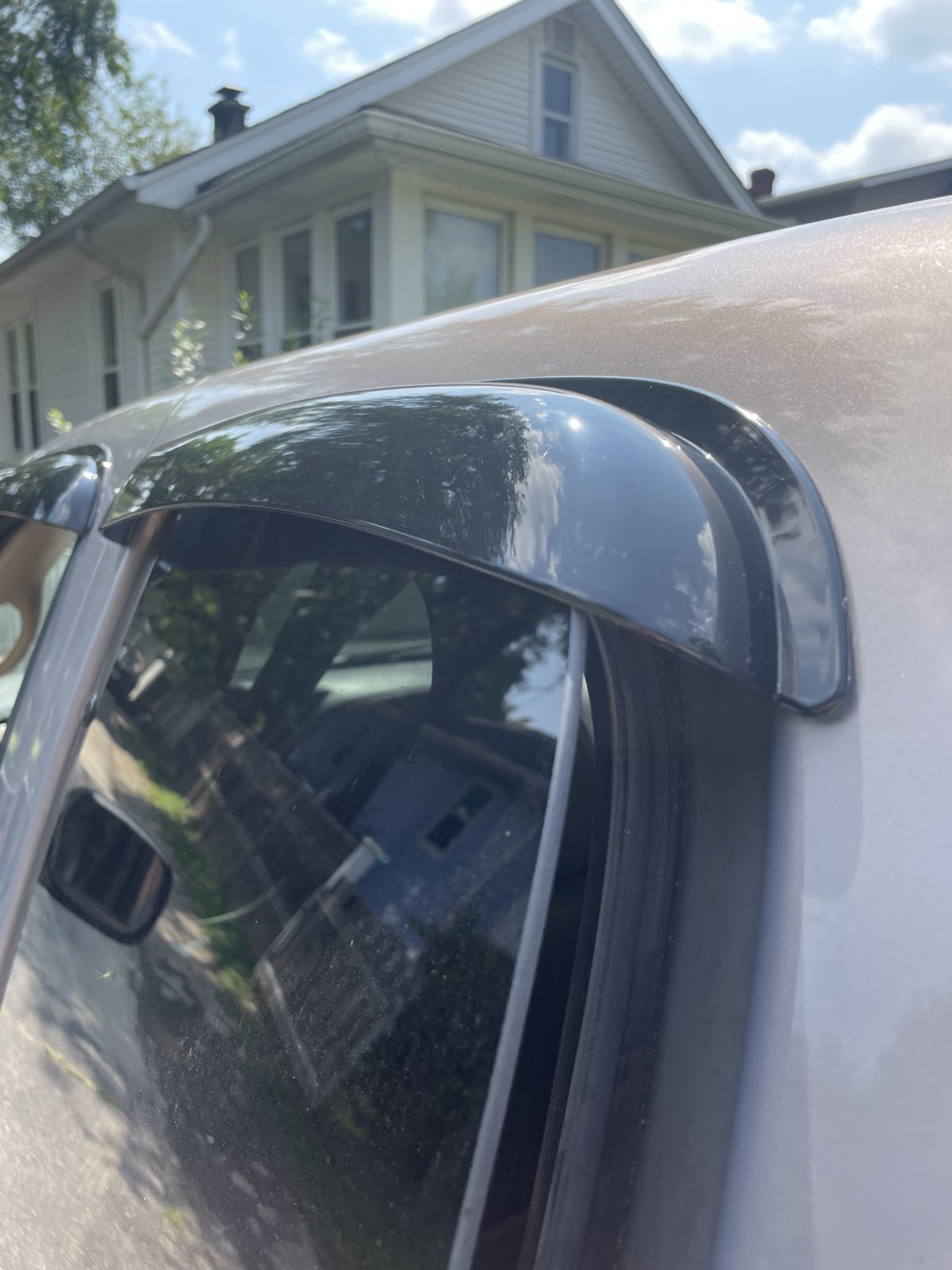

    I also got new window vents! My grandpa put a set of these on shortly after he bought the truck, but they were chipped and cracked by the time I got them. I took them off but never got around to replacing them until now. Very happy with how they look and the increase in wind noise is minimal.
    One thing though- the rear vent windows hit the visors when open. I can already see that it’s pulling the adhesive away from the visor. Not really the end of the world as I don’t use them often but it would still be nice if I could.
    I finally put in a resistor on the headlights too, so I can finally have a high beam indicator on the cluster. I bought an ultra cheap one from superbrightleds.com, and I wasn’t sure that it would work, but it’s great. I mounted it nicely with double sided tape.
    I also finally developed a bunch of rolls of film I’ve taken over the last few months. The truck was the subject of a bunch of photos.
    The truck is going to be in the shop for a week or so in August. They’re gonna (finally) fix the 4WD and find the evap leak. I’m also hoping to put new bumpers on the truck this summer.

    How bad was it to get rid of the old adhesive? I should probably replace mine, not because I necessarily like them but because my paint has faded around them and one of them is completely busted with another one coming unattached. Just been dreading how much effort will be involved with getting the adhesive off.

    It's super easy if you have a legit 3M eraser
    This is one of those parts where you don't want to screw around with the alternatives, and don't buy this product from scAmazon or fleaBay, you will get a knockoff.

    It took me a while because the old ones were on there for 22 years. I didn’t have one of the fancy 3M erasers shifty mentioned but I used a heat gun and a plastic razor blade and it worked well. Scuffing the paint up a little was kinda inevitable but I buffed it out fine.

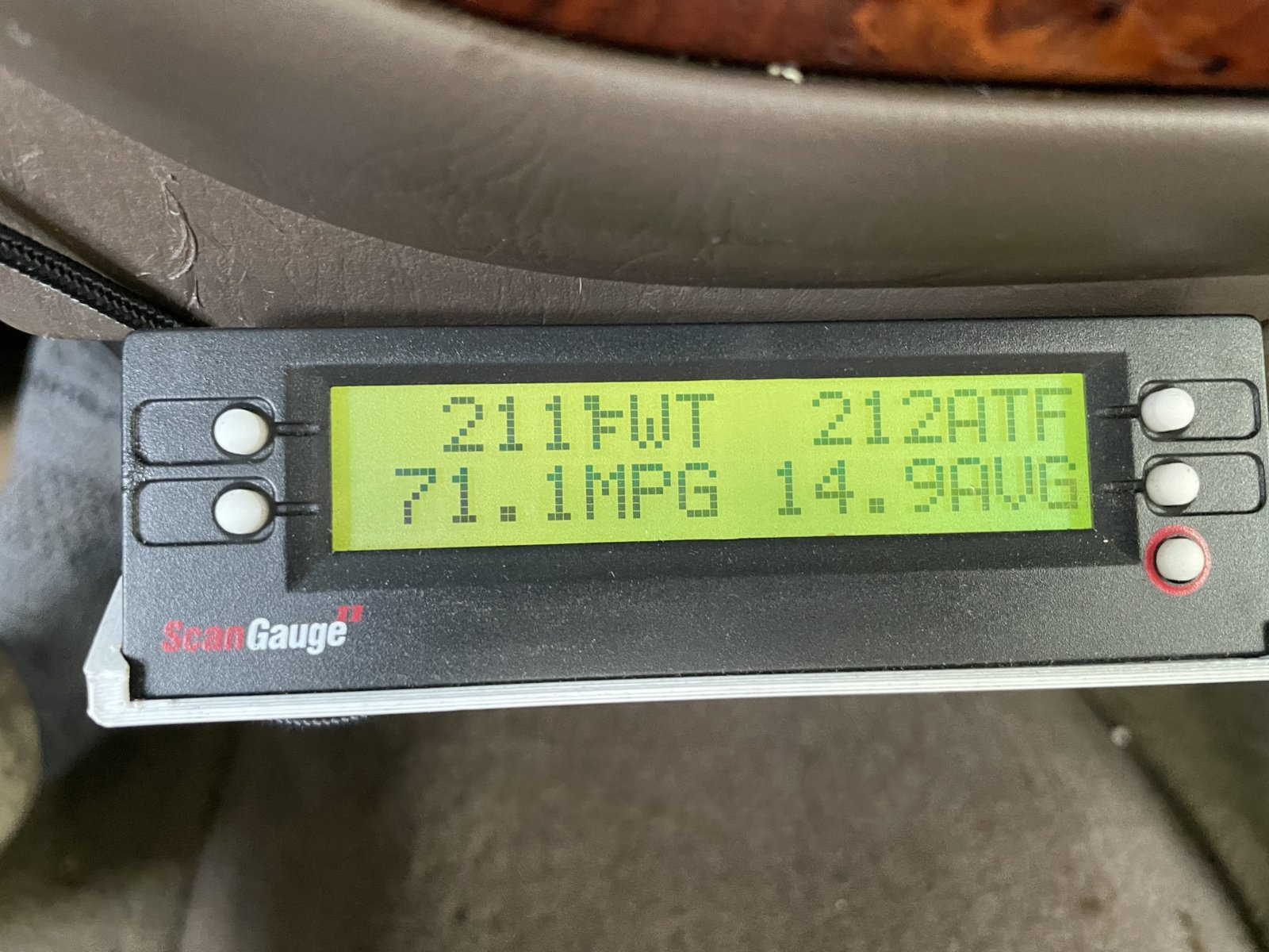

    This is my first time in the heat with the scangauge hooked up- not good. Of course the temp gauge on the cluster is right in the middle.
    Almost certain the fan clutch is bad. The fan doesn’t roar at all and I can very easily see that the fan doesn’t spin up when you rev the engine. The bottom piece of the fan shroud is intact and the radiator was replaced in 2016 when the pink milkshake happened. Coolant, water pump, and hoses were replaced a year and a half ago.
    An Aisin fan clutch is like $150. Is it worth being 3x the price of others? Have any of yall ran an aftermarket fan clutch?
    Edit: this is also after 30min of standstill traffic in direct sun and 94° heat.

    I think $150 is reasonable for that specific part, knowing the importance.

    I started thinking logically again and ordered the Aisin.

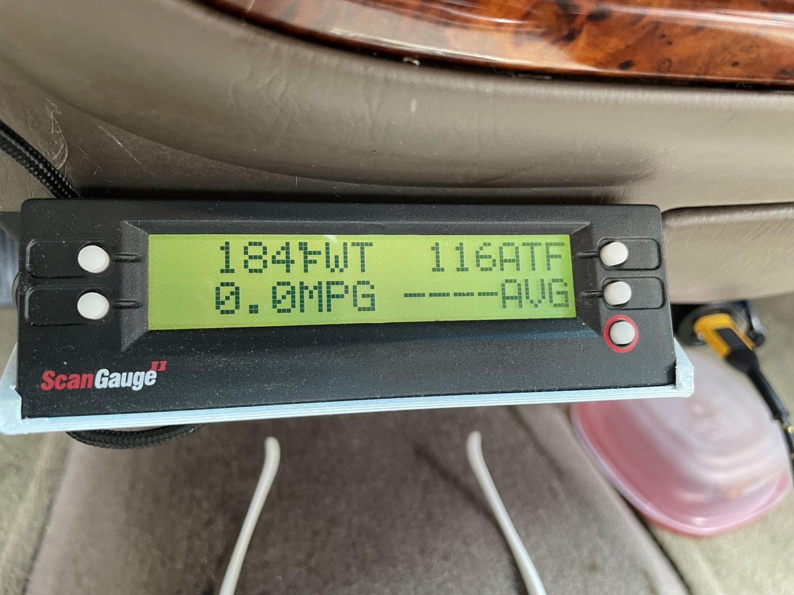

    Success with the fan clutch! It’s only 80° out today, but this is after half an hour of idling:
    Before it would’ve slowly creeped up to at least 195°, and the ATF temp would’ve been at least 155°. Feelin good.
    Removal and installation was easy. It really pulls air now, I guess I never realized how worn out the old one was. I also got to use the new radiator hoses that I ordered two years ago when I did the timing belt.
