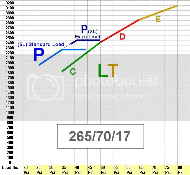

    Very interesting information Where do you find the suggested psi for the tire? I looked at the side. It only has max psi listed at 80psi for 3700 lbs load. My understanding was the lighter the actual load on the tire the less pressure you need regardless if the tire is C load or E load range.
    Now more aggressive tires, such as mud terrains, will generate heat regardless, but much more when operating at lower psi.
    Is there any information regarding the load range and the need to run higher psi, even when the actual load in lbs. is low? I’m going to do some research on this.

    I also found some info in this thread. I guess I will increase the pressures to about 45psi, but it will get choppy. Thanks a bunch for the information!

    Passenger vehicle tires are considered flat at 26psi. Once you run a tire below that the sidewalls start to heat up. That’s when you can start getting the heat ring on the sidewall. Another reason why you can’t patch a tire on the edge. That’s where the tire round off and it’s constantly flexing, which can cause the patch to fail. Bend a piece of metal enough times it’ll break.
    All tires have a maximum psi and at the max that’s where you’ll find the max pounds the tire can handle. For example a 275/65r20 Toyo A/TIII at 80psi can handle 3748 lbs.
    All vehicles have a door jamb sticker with the psi you’re supposed to run. That sticker is the air pressure for max carrying capacity and payload. Some companies actually had a loaded and unloaded pressure for the vehicle. Ram actually had a button inside that would change the TPMS from loaded to unloaded. It was something like 60 in the front, 80 in the back loaded and 50 unloaded. The front typically will never change since the motor and front end stays the same. The rear can go from empty to hauling 1500 pounds in the bed or towing 12000 pounds.
    For the guys that drove a street queen daily driver and never towed. We would put their front tires at sticker and the rear at 35-40. The trucks always drove better and were complemented by the driver. If you drove a tow rig then sticker front and rear. If you randomly towed, sticker on the front and 50-60 in the rear.
    No need for more air when the payload doesn’t require it. I’m running my setup at 38psi and I might go to 35. More air on a half ton truck with a heavier rated tire is ridiculous. All you’re doing is over inflating, which will cause the center of the tire to go bald faster. That means less of a footprint and less traction. You can put too little of air in some tires. That’s when you check the pavement dust for equal wear or do the chalk test (you can check over inflation this way as well). Too little of air you can put too big of a footprint and wear the outside of the tire faster than the center.
    The trucks that required 10ply rated tires I’ve upgraded to 12ply. Then ran them at a lower psi that still accommodated the payload and the ride was way less harsh. Same for half tons with a standard 6ply rated tire. An XL, 8 or 10 ply rated tire rode much better because the way they took bumps and such. 12 ply was too harsh.
    One last thing. The ply rating is actually an expression. Plies don’t exist anymore and it’s just terminology for payload. Because of modern tire engineering and the materials used, companies are able to create greater tire strength and capacity without adding layers or as some would call plies.

    I found this document with load vs psi charts for various load range tires. It clearly explains how to calculate correct psi going from p-rated to LT-rated tires.
    https://www.toyotires.com/media/2125/application_of_load_inflation_tables_20170203.pdf
    It seems 265/60R20 112 load index tire is rated about 2470 lbs for 35psi. This is stock Tundra TRD tire.
    If you go to LT275/65R20, which I have done, I would need at least 45psi to be able to carry the same 2470 lbs load.
    Now the door sticker psi states the max load. If you are not hauling anything, you can likely go a bit lower at the rear, and inflate back up when carrying stuff.
    Again, thanks for the education!

    Absolutely spot on, G. also explains it very well.
