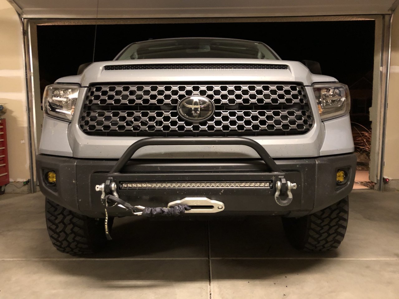

    Commence the install of SR30 LED Bar and the X20 winch.. Then on to some cutting!

    Added the SSO Slimline last night. Took too much on for the night with the painting off the end caps as well. Finished at 2:30am with a little alignment issues of the end caps that I can fix later. But more importantly the X20 could not fit with the SR30 Rigid, and the solenoid is just sitting next to it. I will need to reposition that as well.

    UPDATE UPDATE UPDATE
    Talked to Kevin at SSO im great length. It seems they have had one other problem with the fitment and thought it was just the winch (Not an X20 or Xeon). The tabs they use for the lightbar mount are standard tabs. The Tundra being so shallow seems to need a little more cut out of the tab mount to allow the bolt to drop a little further down and out towards the front of the bumper. Due to this issue, there will be a redesign (slight) of the bracket, which will basically consist of extending the hole a little more where the bolts slide in. This will make the light bar flush, or protruding from the front slightly, rather than flush to the inside metal wall of the bumper. Not a big deal at all, but if it stops the possibility of such a tight fit, then it is a good thing
    Incidentally, the Heise and BD bars are not nearly as deep and "styled" like the Rigid has for heat sinks, and this is where the issue is, the Light bar. It is all a learning experience, and I have to commend Kevin at SSO for being right there with me and taking the time. They have been excellent, and ever offered a discount that I declined, as the money doesnt mean as much as the support and empathy.
    I will drop the bumper, use a dremel to bring the tab mount forward a little, and figure out the relocation of the solenoid to a better more aesthetically appealing position (for my peace of mind).
    Hope this dialogue helps everyone!

    Updated SSO install pics after a slightly better placement of the SR30. I dremeled the mount as much as I could to bring the light forward, but it still doesn’t fit as well as it should. Also zipped down the control box solenoid and double sided taped it.
    Added the Smittybilt 8’ extension as well for the winch power.
    Adjusted bumper ends for better fit and even lines..
