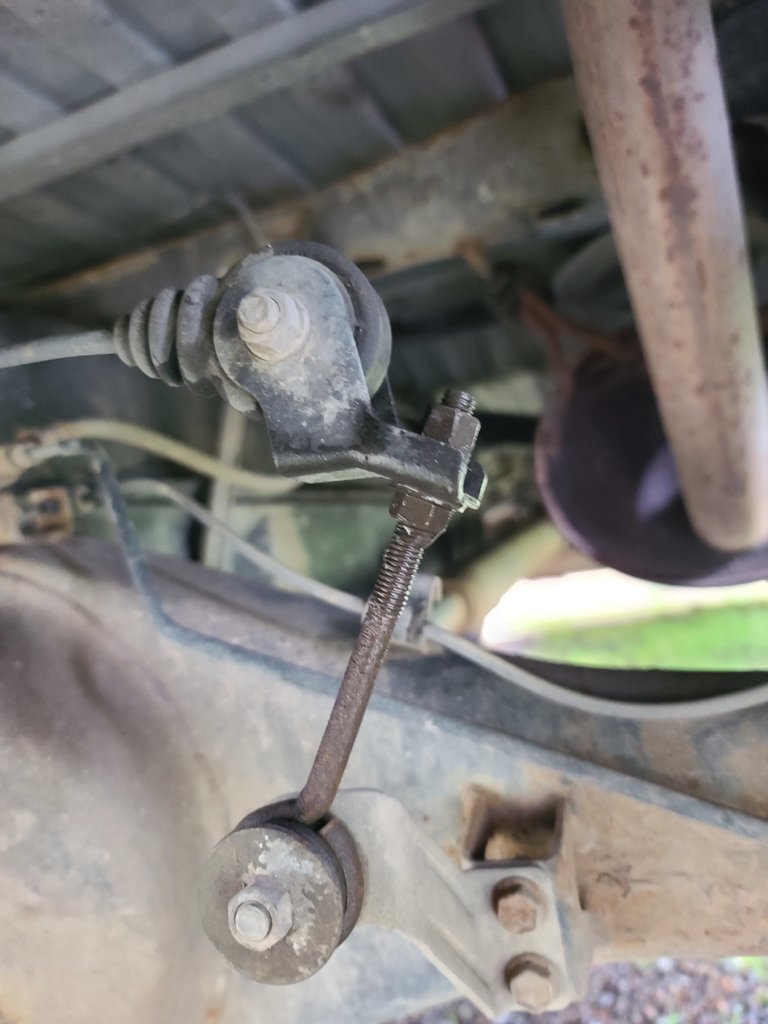

    I recently commented about how my braking off road is subpar. Someone mentioned to adjust the rear brakes, which involves jacking up the rear and fiddling around the drum brakes...
    Would making the adjustment in this thread make that job unnecessary or redundant?

    Since this threads genesis, I’ve re-built my entire braking system. I lowered the nuts to experiment with the new brakes, but ended up raising them back up to previous raised location with better performance.

    You can try raising the nuts a bit. Doesn’t require any jacking up. Another thing to do is make sure your parking brake is adjusted properly which is key in the self adjusting mechanism of the ‘Star Adjuster’. You can self adjust the ‘Star Adjuster’ through the little window on the drum backside.
