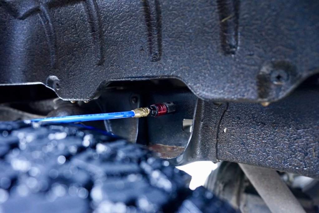

    How about something like this one I mounted on my rear bumper? Not very obtrusive and pretty robust, don't think you would step on it and break it off.
    Drainbung likes this.

    That’s exactly what I ended up doing, I used the ARB quick connection though. Looks good
