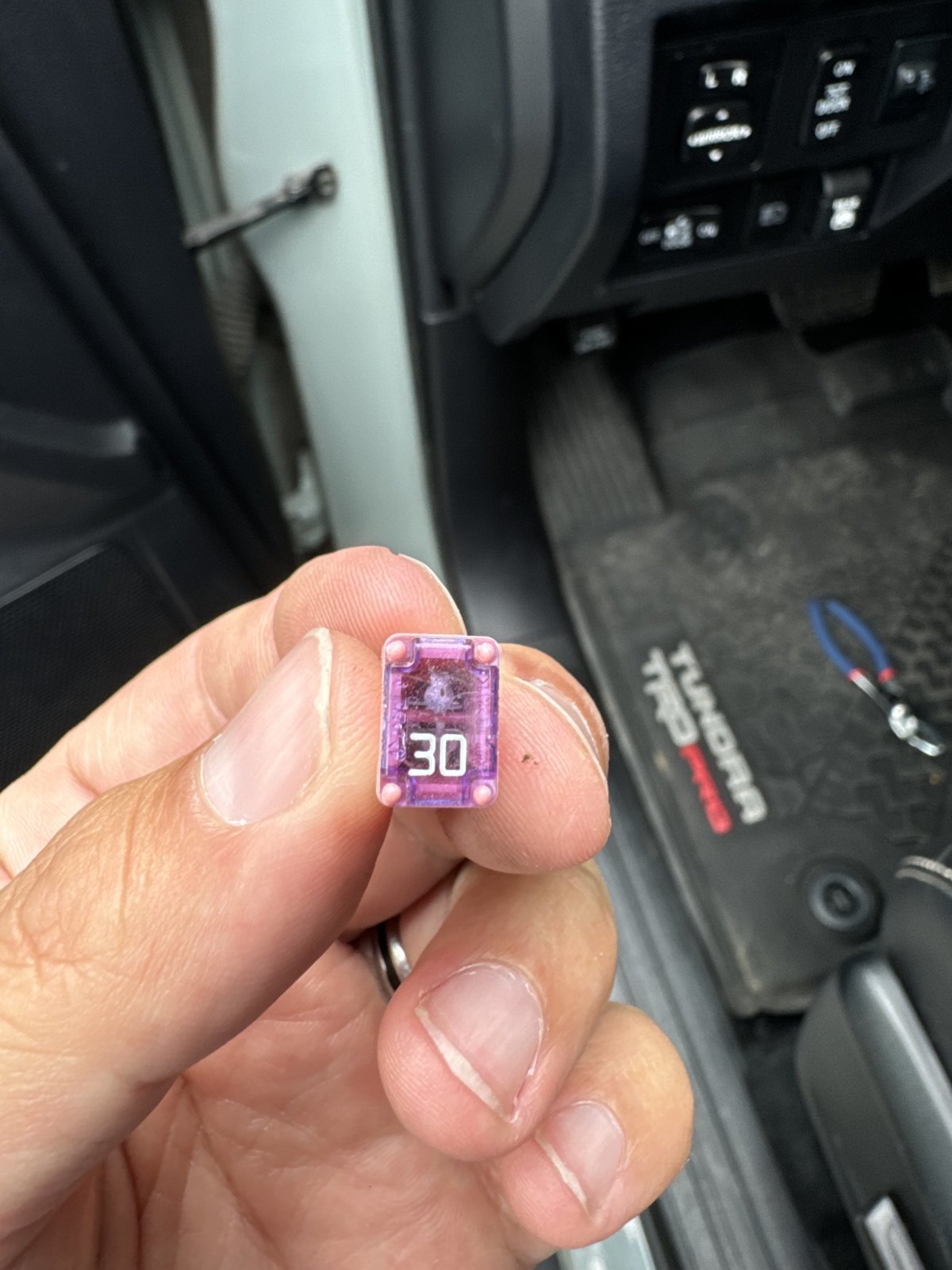

    I'm having issues with this lighted window switch. Installed on driver side only and now my key fob is not working to lock/unlock car or start vehicle without touching to PTS button. Put the OEM switch back in and still having the same problem. Power locks do not work on driver side but window does, SRS airbag warning on dash, passenger windows nor working. Power locks work on passenger front door. Did not see any blown fuses in cabin fuse box. Any suggestions?

    Check all fuses under the dash and in the engine bay. These trucks are sensitive to electric surges and its very easy to blow fuses.

    Thanks, I wanted to provide a little update/partial resolution:
    Used a multimeter on continuity setting to determine that the ECU-B NO.2 fuse had blown in the cabin. Replaced that and the SRS airbag error went away. I now have power locks and keyless entry restored...but still cannot operate rear windows/back glass from master switch. Tested all of the mini fuses under the hood for continuity and they checked out. Not sure how to handle those multi-colored squares (Type B fuses or relays???). Have a service appt tomorrow...will update the thread with resolution and a much lighter wallet -_-

    So, I got these today and none of my windows work from the master (or the original one) BUT the front passenger door does work (even without the ignition on) I checked EVERY fuse 3x (die in a fire whoever put those fuses under the driver side dash) I have no rear window either. Has anyone seen this situation?

    Definitely sounds like a blown fuse(s).
    https://www.tundras.com/threads/cartrimhome-illuminated-window-switch-problem.105074/#post-2704723
    Does your stock master switch have front driver and passenger auto window switches?
    Same thing happened to me but my wiring/fuse box set up (2021) is different than your 2013.
    Are you sure all your fuses are ok? Use a multimeter to check continuity. That is a quick way to check if the fuse is blown or not without having to pull out/visually inspect each.
    Also check fuses in the engine bay. I had blown one under the dash and one in the engine bay. Dealership replaced the 30 amp large pink fuse in the engine bay today and we are all back to normal.

    That may be the problem, I got the rear windows back by replacing the square 30amp fuse under the dash, the driver window is not working but the passenger does on it's own.
