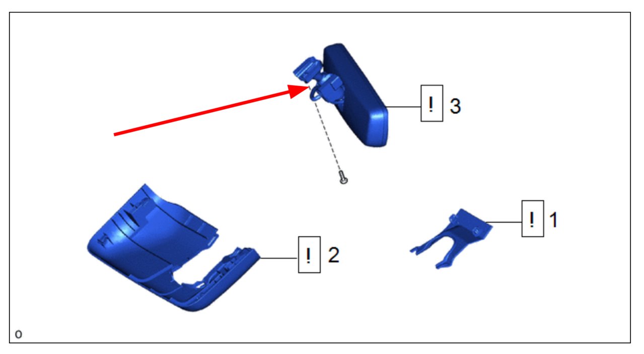

    Chiming in because I keep getting emails about it. The Dongar 10-pin Type B adapter plugs into the mirror harness and doesn't require removing the overhead console. The adapter has been installed in many thousands of Toyota & Lexus which have been using this 10-pin mirror for the last 6-7 years, but just became standard equipment on the latest generation of Tundra. The connector is underneath the plastic shroud at the base of the mirror against the windshield and is completely accessible without tools. The 5-pin adapter on the Dongar site was only designed for their 5-pin rearview mirrors and should not be plugged into Toyota's "option connector" which coincidentally uses the same terminal housing.
    Here's the location per photos from Toyota Tech Info for mirror connector on the 2022 Tundra:
    How to access connector:
    Video showing installation in latest generation Sienna:

    @Maharisc + just to keep everyone informed: The non-integrated dash cam does not use the option connector. The 4Runner's (earliest vehicle on your link) dash camera option still uses a hardwire + T-Tap kit to the fuse box. The 5-pin connector up there isn't present. From Toyota:
    For the Tundra, I posted the official Integrated Dash Camera instructions from Toyota. Hopefully it helps you guys make the most informed decision about whether to purchase the OEM Toyota Integrated Dash Cam, choose your own camera + 5-pin option connector adapter in the roof, or 10-pin Type B adapter (once the supply chain/chip shortage in Asia works itself out, there's a shortage of USB converters everywhere). The 10-pin connector simply covers many more vehicles (hundreds of thousands since ~2013) but I can see how the 5-pin adapter would benefit base-model owners who don't have the autodimmer.
    There actually is constant-on in the mirror but the Dongar adapter is wired as ignition-switched. Regarding constant-on cameras, I usually shy away from it because parking mode in dash cameras is limited in utility. The parking mode on the Toyota integrated dash cam or any current Garmin Dash Cam for example only records forward and activates upon detecting a collision. That means the camera will absolutely not record any door break-ins or somebody stealing from your camper shell. I can say that its better than not having a parking mode at all but the Dongar adapter is just wired as ignition-switched because not every dash camera has a sleep mode and I don't want to get people stranded.
