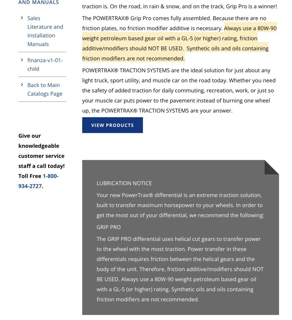

    Pretty sure I have Valvoline 80w90 non synthetic in my rear diff that was put in with the Powertrax. I’ll probably stick with that even with the new gears. My mechanic seemed to really like using it.

    Valvoline is good. Powertrax also recommends Mobilube, been running that for a couple years.

    About 80,000 miles on my Powertrax now with nothing but basic-ass Valvoline 75/90 dino oil. Sounds and drives same as ever.
    I change it annually, which is about 26K miles.

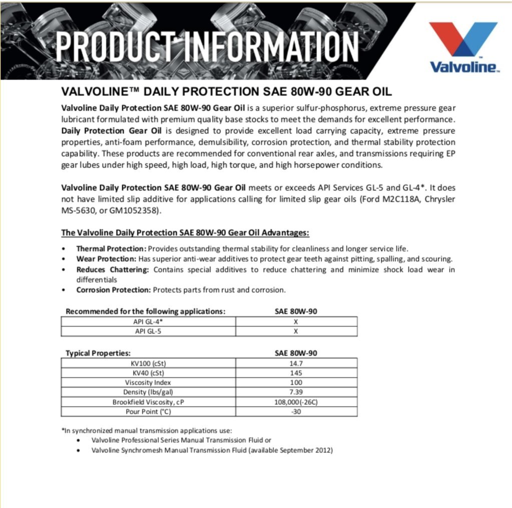

    Product information sheet from Valvoline states 75w-90 is both synthetic and contains friction modifier. The information sheets from 80w-90/85w-140 state they are conventional oil and do not have friction modifier.:notsure:

    My bad, I am actually using the 80w90 not 75/90.Had to check an old post I made about the gear oil I was using.
    Vizsla[QUOTED] likes this.

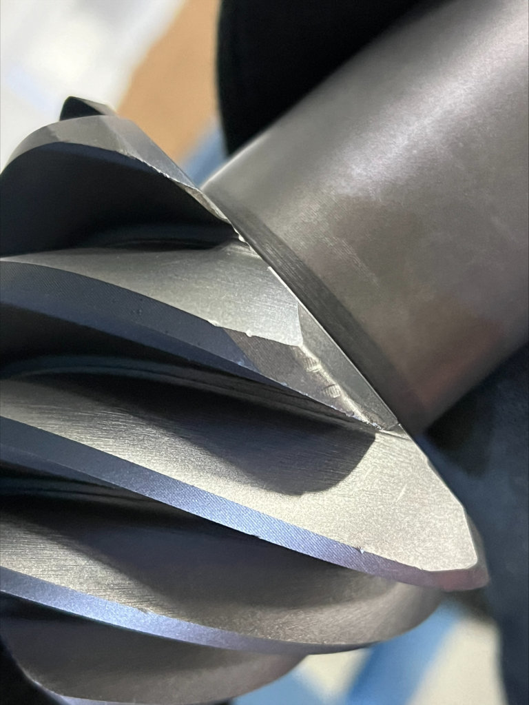

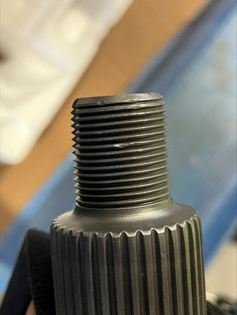

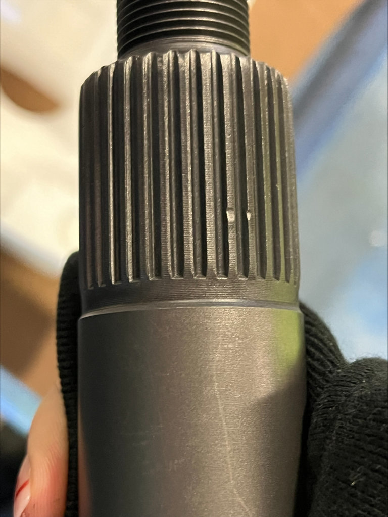

    processed-7C4652EB-D4BF-455C-9674-96DF25F0CB70.jpg processed-EBE7137D-ED56-4466-A357-5A9242C1D217.jpg processed-E396A15B-D590-439A-8FDE-BE91CF0AD40B.jpg
    Dropped off my gears at ASF Motorsport for their ASF treatment. Super nice guys who are passionate about their craft.
    They sent me these pictures once they removed the factory black oxide coating on the gears. The mark on the pinion threads and the splines shouldn’t matter and I don’t think the tiny dents on the gear surface will even make contact with the ring gear. I don’t think any of the 3 blemishes will make a difference with quality or longevity, so I approved work to continue.
    Thanks for doing the legwork finding a local polisher, @Silver17!

    I’m no expert but I’d agree those look like pretty inconsequential blemishes to me. No problem! Glad you’re happy with your experience so far with ASF. It was definitely a nice painless experience dealing with them and dropping off/picking up in person. The end result is pretty awesome as well.
