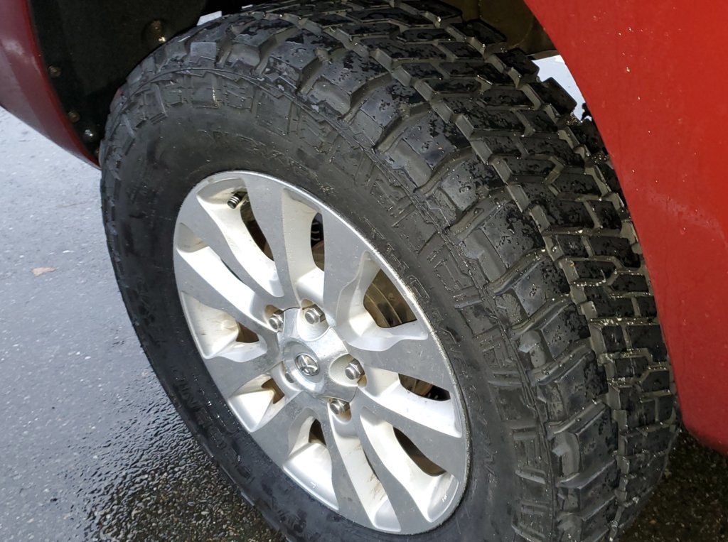

    Went and got new shoes 295/65r20 today to go along with the 5.29's. I put about 120 miles on the gears after reducing the pinion shim. There is a slight whine on decel/coast at 60 to 45mph. Below 45 it's not noticed edit: its there but gotta listen for it. Diff case is not hot and went through a few cool off cycles.

    @carn_dogg well I couldn't resist with the wet roads and I got about 350 miles on the gears...
    Speedmaster hooks up fast taking off and will get you sideways and fishtailing. Certainly will put a grin on your noggin. Haha:burnrubber:

    A little soon... But it does take off smoother, seems less resistance? Shifts nicely. I like it.
    Yesterday I was at 70 with 2200rpm and 75 was 2500rpm for a short time with 35's. Oh and it holds 6th and doesn't downshift as much. Pretty much what a lot were saying about the 5.29's.
