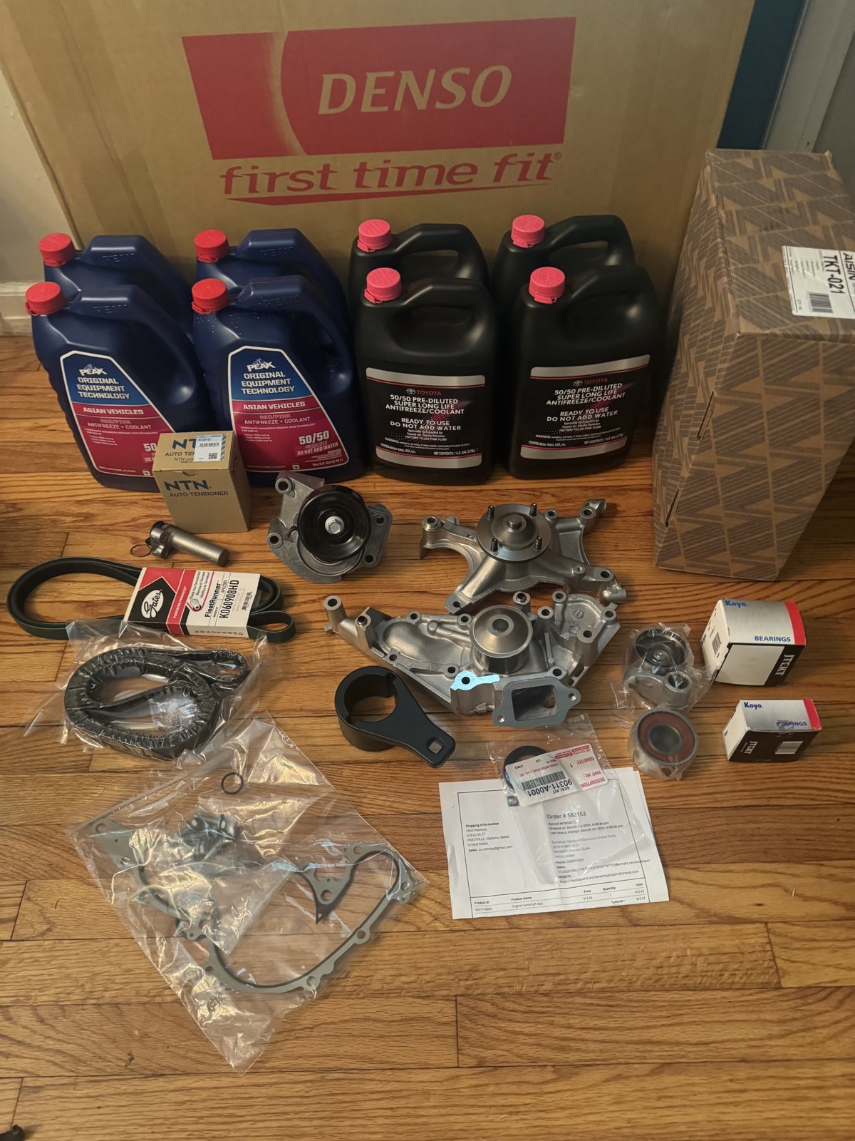

    OK, I'm getting ready to tackle within the next two weeks once I've watched enough videos and confirmed I have everything I need. I finally found my record for the last timing belt change from my old shop and now I am approaching the miles limit within the next 500 miles
    As I discovered earlier, the shop that did the last timing belt change used green coolant. Therefore, I will do about three flushes including draining in the engine block to ensure the green is gone. I bought aftermarket premixed coolant for the flush and Toyota for the final
    Aisin kit, Denso radiator, serpentine belt, Gates serpentine belt, bearings, and crankshaft seal from Ourisman Toyota.
    What's missing? Radiator cap, thermostat, radiator hoses
    Hopefully, I will watch enough videos and everything will go smooth. However, knowing me and the fact that I've never done this before, this project will take me 3 or 4 times as long and I'll have several questions, hence this thread for when I'm stymied and need help

    I don’t see cam seals. I know it’s a bit harder on your VVT 4.7 but you may want to consider replacing those.
    Weagle[OP] likes this.

    And don’t forget FIPG for the water pump.
    jimf909, AZBoatHauler and Weagle[OP] like this.

    I thought I had ordered the camshaft seals per @shifty` recommendation. I'll have to double check that and be sure I didn't put them somewhere else
    There were two different bearings. I don't recall what those were.
