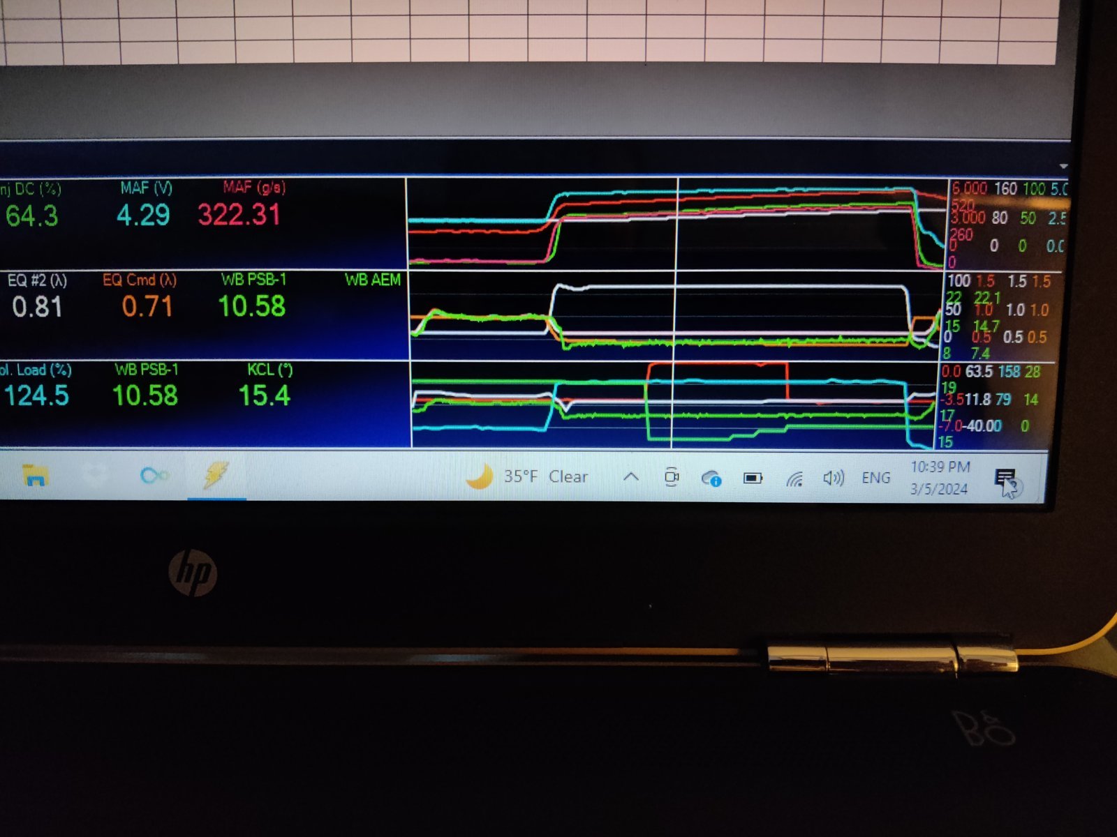

    What random lean/rich issues are you having?

  16. Mar 5, 2024 at 8:00 PM

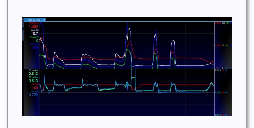

    Well geez I'm behind the curve here lol. Why is the EQ commanded flatlined like this, it isn't tracking with B1/B2 or A/F at all?? @Grenades4Bacon your MAF can't be dialed in if closed loop. What tune are you running? Stock narrowbands can only read down to . 81 lamba I believe but your commanded and A/F should be tracking close. Also is your PE table tuned? Here's a log I took earlier for reference, middle column in WOT EQ commanded and A/F are close, EQ1/2 maxed. This is where you want to fine tune IC/MAF/PE to match or how I try to do it.

  18. Mar 5, 2024 at 11:00 PM
    Mdl
    Mdl Hey there...
    Jun 14, 2023
    #98638
    2,904
    PNW, WA
    2007 TRD SC'd
    JBA Longtubes, Snivs 2.0 SC pulley, ASP crank overdrive pulley 6.71 in, DD Full 3inch dual exhaust, IPT valve body, Airbox mod, 4.5inch intake, Denso 750, 450 Walbro, W/M injection, GM 95mm TB, SABM, Camburg UCA, Icon shocks, Speedmaster LSD, Motive 5.29 Gears, Mickey Thompson Baja Legend EXP 35's, DIY Traction Bars, Tuning by snivspeedshop.com
    Good info. I also think he is not tuning it, working with OTT. But hopefully he can pass on the info to get it dialed in. I also thought @snivilous reached out to give a basic tune but not sure what came of it. Guess no bueno...

    Hmm oh okay. Hard to tell without a full datalog on what he has going down but something ain't jiving that's for sure. Was OTT Orange virus tuning at one point with the Tacoma's?
