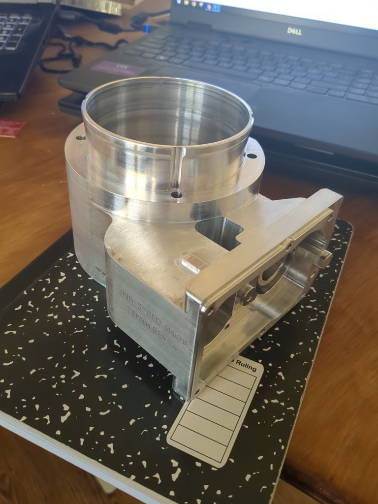

    Well I've done 50 miles so far with the 95mm throttle body with zero issues. Neighborhood, stop lights, interstate, drive throughs, launch from a stop, etc. I still can't tell it's there besides the intake noise being slightly different.
    I'll get a few more miles and some longer trips on it, and then build out this second prototype. Right now I honestly wouldn't recommend it to anyone, there are zero downsides and zero upsides so far :D I'm hoping one of the guys making big power can get an apples to apples comparison of the second 95mm versus a stock unit, because it's either a total useless upgrade or my truck just doesn't make enough power to see any benefit from it--which also gives some idea of if a RCF TB or porting a TB is of any use, since this absolutely dwarfs those options.

    Richard holdner and his blower data would say otherwise on having a larger TB/intake. Bigger is always better. We're ready for these when you're ready!!

    I do wonder if the intake or the snout is the limiting factor, you have to figure I have a completely stock (besides the pulley) Magnuson 1900, I don't even have the extra holes drilled in the intake box. I think I'll end up porting the snout and making an intake box (few people have asked for that too) just to see if I notice any gains. But I think for your average person looking for a cost effective way to get more juice out of the blower, the TB isn't going to make a difference. It's one of those modifications that's pretty far down the priority list after a pulley, larger intake, etc.
    I'm still thinking I'll send it to you, with you already having a 95mm and making a ton of power that gives a lot of extra data points, plus we know you're open to tweaking things and blowing stuff up :p

    I wouldn't doubt that the box and snout are limiting factors. Make a new box let's do that lol

    Hell all I have is a catback exhaust too, so when it comes to flow improving mods I've done nothing but now have a huge throttle body and that's it hahaha

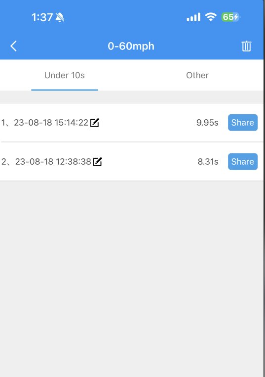

    Are you saying that your 0-60 time is 8 seconds or higher?

    I had several more runs, got a new phone, this is all that transferred. I think my best was 8. It's a pushing the button & taking off thing.
    These were on a runway at a private airport.

    I timed my truck 0-60 the other day and the results were very disappointing. Apparently being super heavy and at high elevation is bad for performance. :frusty:

    What button you talking about? The reset button on dragy? You don't need to reset then launch, the dragy only starts once you start moving. Regardless of reset or not. Reset just clears the screen basically. At least thats how mines been working.

    Maybe that is my problem, didn't read the fucking manual. I have been pushing the button.

    I tap the shit out of the reset button before launching. Applying brakes and then throttle to load it up seems to move the truck enough to trigger the Draggy I've found, so tapping reset repeatedly to make sure it doesn't premature go until right before I let off the brake solves that.
