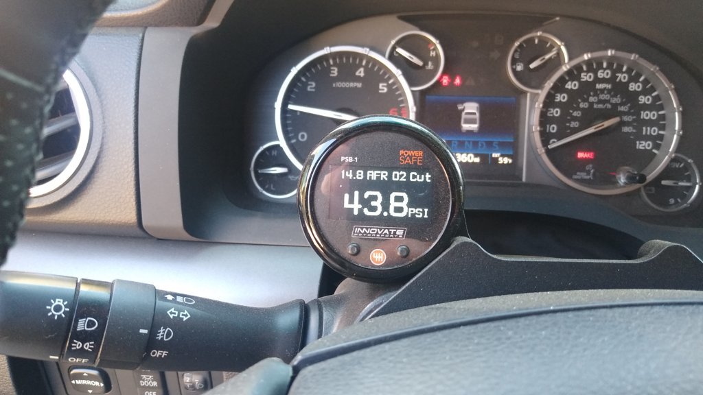

    Anyone ever have map sensor issues with innovate? Truck sat for a few days now shows 40psi boost all the time

    Try disconnecting power from the unit, then reconnect. Else, inspect wiring - maybe a critter chewed on it.

    Nothing obvious wrong... Called innovate and they said sitting at 43psi means map sensor died. Should be under warranty
