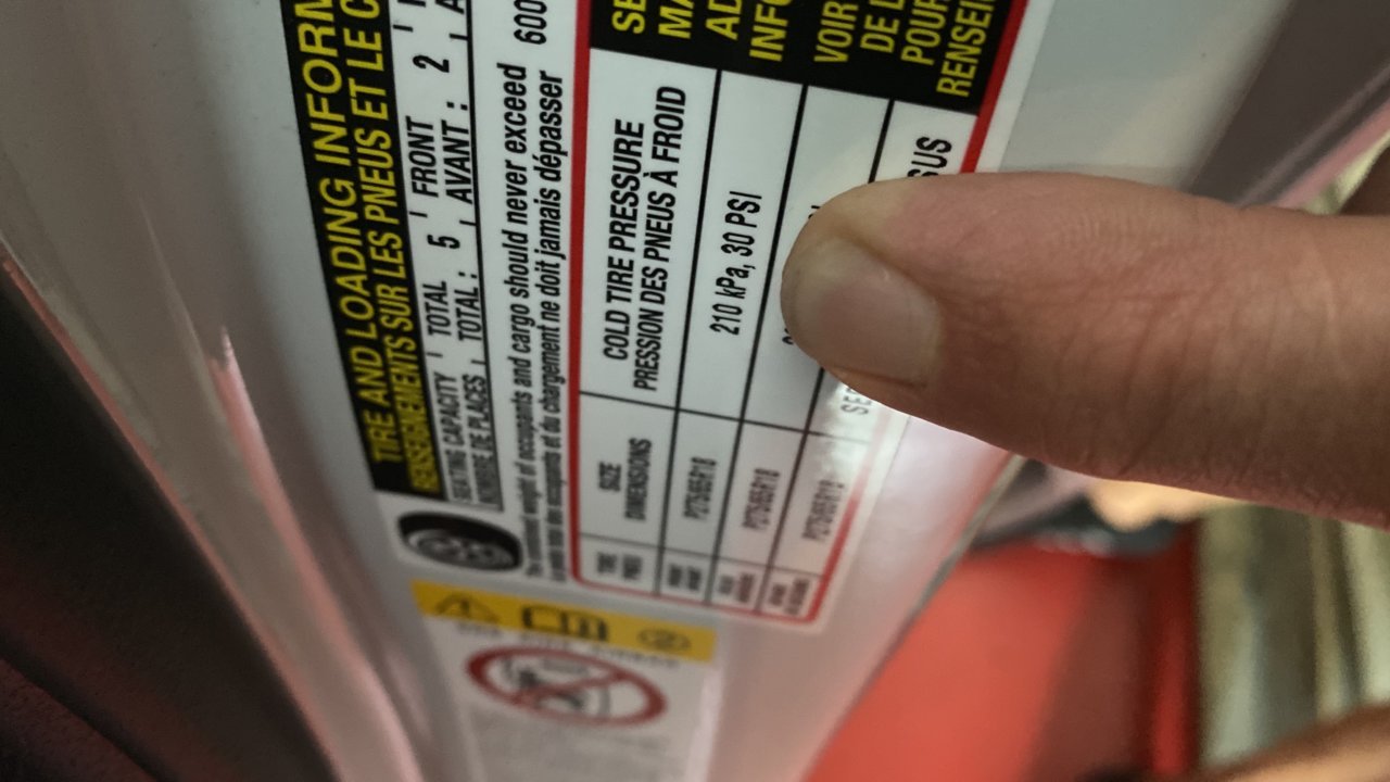

    If the back of your tundra is lower than the front the steering will be looser . Way noticeable towing.

    Thats way too high unless its completely loaded and towing

    For an Lt tire that’s not too far off. Lt tires need more psi than P rated

    Not really. Unless your using them at their weight rating . Mine have 30 psi in them and the tires are wearing even. 45 psi feels like they are made of concrete.
    my tires say max load rating 4080 lbs each at 80psi That would be awful. How could you load a front tundra tire with 4080 lbs?

    Door jamb says 49 psi
    Ko2’s
