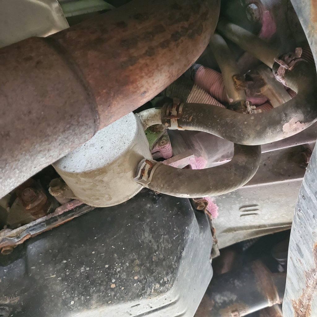

    I recently did my water pump and was still smelling coolant. Come to find out it was a squeeze clamp that I'd neglected to secure back on. However, I still caught faint whiffs of Pentofrost so upon closer look, I saw traces of dried coolant on rubber hoses with dried splatter in the proximity. Noticed I was losing coolant out of the reservoir. Come to find out there's a small squeeze clamp that holds the overflow hose to the bottom of the tank and it was a mite weak for my taste. I put a real hose clamp on it and filled up the tank to the full line. Will see tomorrow how it looks when I get home from work.
    To make this relevant, I too went looking for the dreaded valley leak and didn't see anything close to what you see. Damn sure didn't have coolant running down the under carriage. Whew.

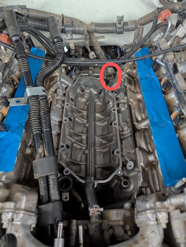

    To get the valley plate out and redo the FIPG of the plate, the inlet pipe has to be removed to get the plate out, because the pipe feeds coolant into the valley plate. That should be written into the procedure i think? :confused:

    Bingo! Thanks. The part right at 6:54 that’s sticking out of the plate cost me 800 ADDITIONAL dollars to replace saying they “had to dig further”. Super helpful to clarify where it is.
