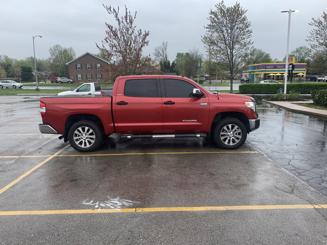

    If you are wanting anything more than level this is not the kit for you.
    Of course when level any pic on a slope will seem like a lot be it nose up or down.
    Here is a picture of a little more level ground and the front looks more accurate in height.
