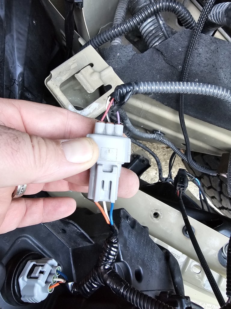

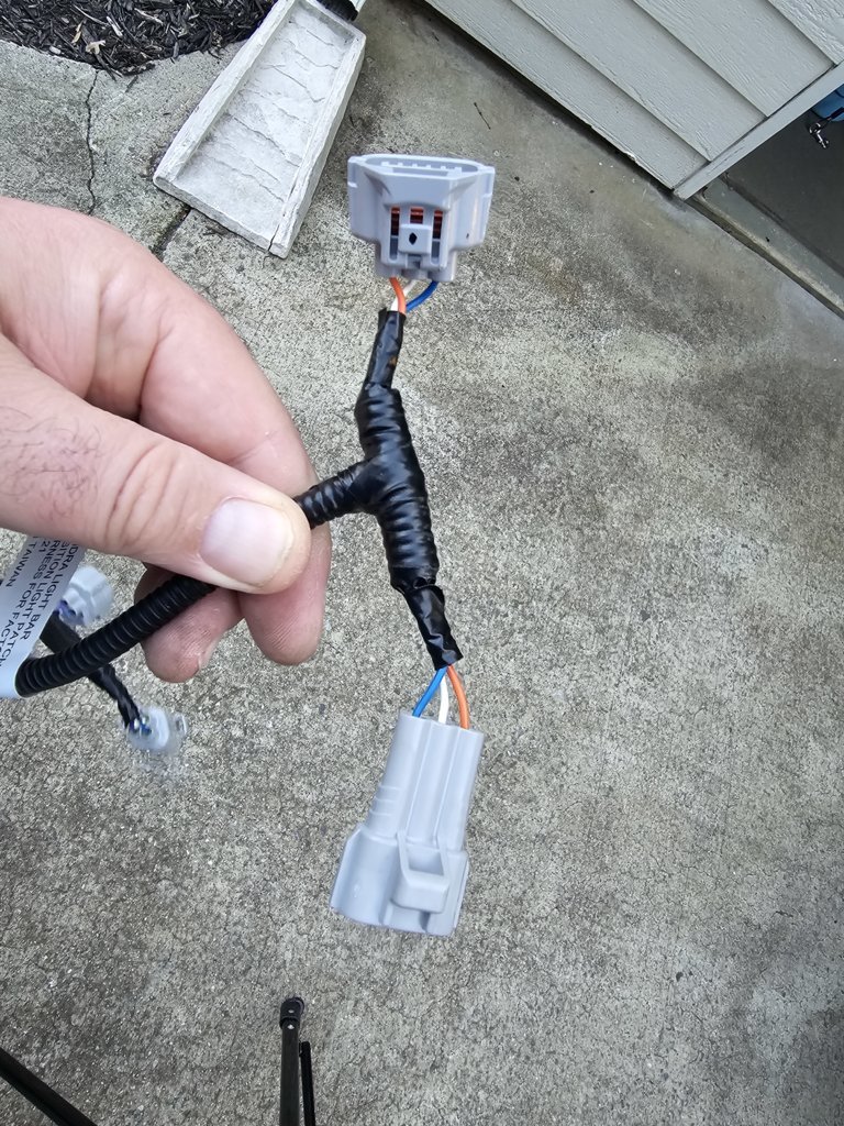

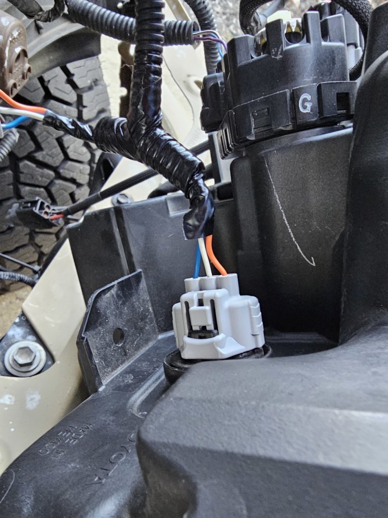

  26. Oct 5, 2024 at 3:57 PM
    #206
    Bryanfain
    Bryanfain New Member
    Oct 11, 2020
    #53431
    8
    North Ga.
    2016 TRD Pro
    Maggy SC, JRT sound System, AFE intake,
    Here are some shots of my connectors. I have tried the patch harness, without the patch harness, all with the same result. Just swipe on lock/unlock. And my 3 way switch is illuminated.
