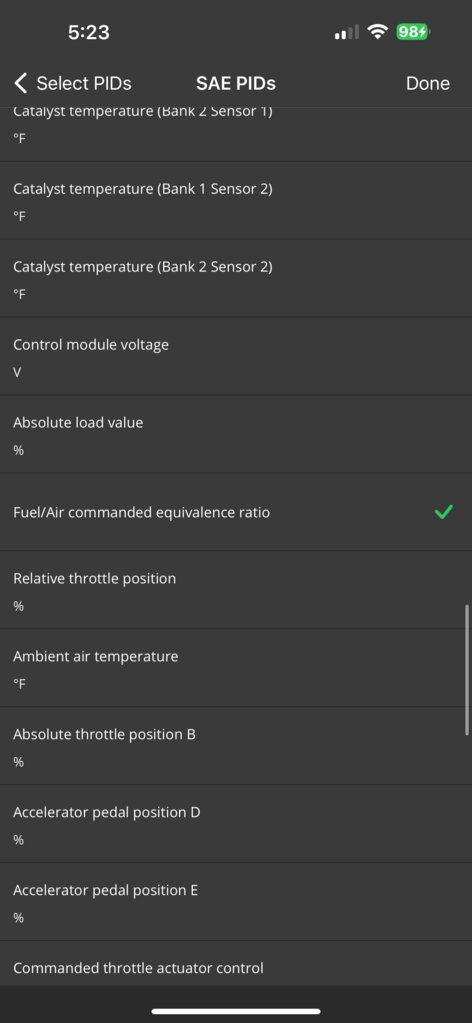

    I’m trying to find the A/F Average, but I’m not sure if I have the right one. Can someone confirm for me?

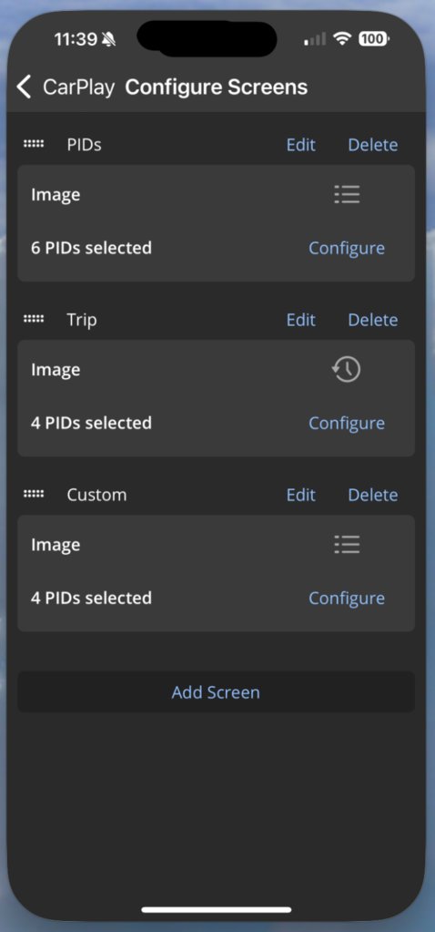

    Sorry to hear that. OBD Fusion works well for me and I purchased the Toyota PID's package. I like it as it can display it in CarPlay, no dashboard but line items. Pretty slick actually.
    I got 14 PIDS monitoring in CarPlay now

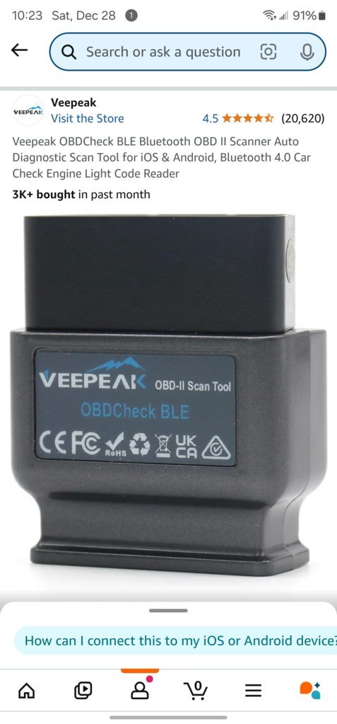

    I bought the veepeak on Amazon and paid for the obd fusion app using iphone 18.2 ios. I dont know if it is the app or the adapter but it willl not connect to the truck. The app connect to the adapter but won't connect to the truck to pull data. Waited 10 mins for it to connect and it won't. Tried it on an android phone and it fail also, saying not obd2 compatible and to check quality of adapter.
    Anyone using something else other than veepeak to pull atf pan data?
    Veepeak i bought is this:

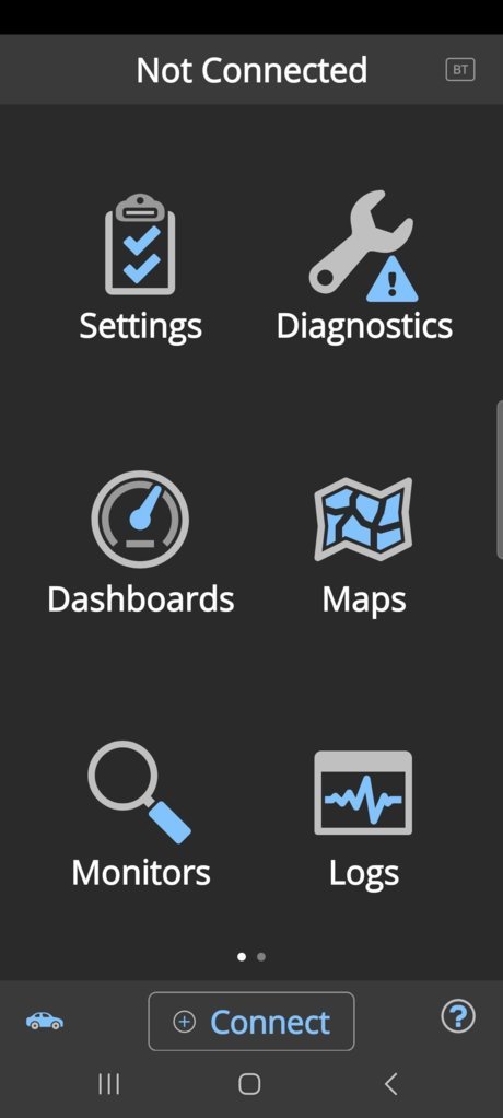

    20241228_104509190.jpg It doesn't do it automatically the 1st time you use it. You have to initiate connection on the phone.
    You have to tap the connect button at the bottom.

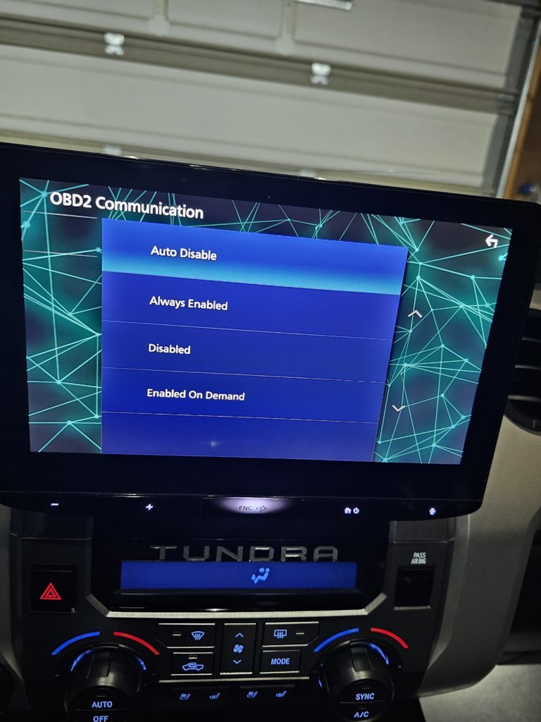

    Ok update. I feel like an idiot. Here is the fix.
    I thought it was the adapter being faulty or the app but it was neither. I have the jvc 10" radio with maestro rr. Under the OBD2 communication i had turned it on to "Always Enabled" because last time i was trying to see if my radio would display transmission fluid temp. There is an option for it but it is X and greyed out. Wont let me pick it. Turning on Always Enabled thinking it would let me pick it. But it still won't. But forgot to turn it back to "Auto Disable"... tonight i thought maybe it had something to do with the maestro. So i put it back to "Auto Disable" and what do ya know. The adapter picked up the truck very quickly. Then i was able to add in the ATF pan and torque converter for display.
    It was a Doh! Moment for sure.
    Moral of the story, leave OBD2 Communication to Auto Disable if you have Maestro compatible Radio like kenwood, jvc, pioneer. Etc..
    Otherwise they will fight each other for data and the Maestro WILL win.
