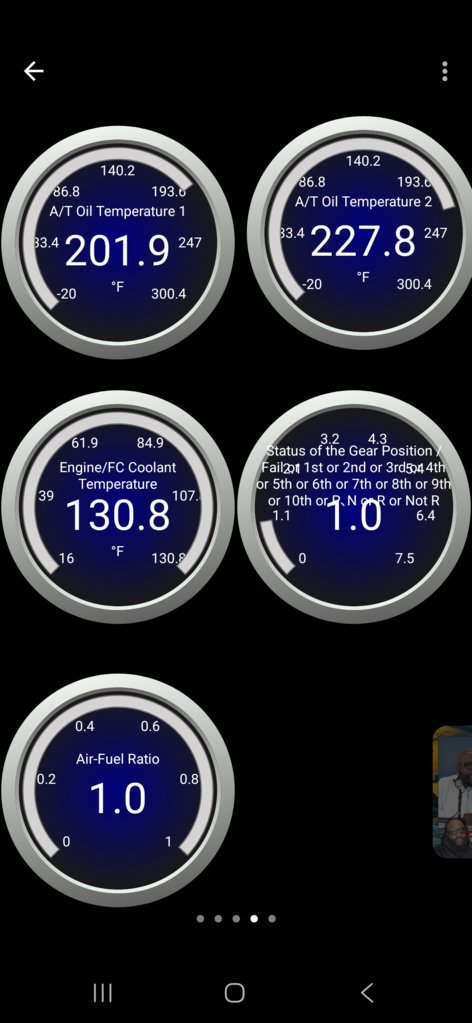

    It's been a year and all codes have been back and are gone. Yes all codrs on both threads, exact same ones.
    Did a drain and fill of 4.5 quarts of Royal purple Max ATF with oil cooler pinned.. back in early January. Made a trip to San Diego, and everthing was good on the way there. On the way back, I stopped in the San Bernardino area, under heavy traffic It did start slipping. I was following an 18 wheeler and was on and off the gas constantly. Lost 1st gear mainly, once I stopped and got off I got a strong smell of burned ATF, more specifically the RP ATF smell. This prompted me to do a 2nd drain and fill.
    Following with a 2nd drain and fill this weekend, but only 3 quarts, cuz I couldn't pin the cooler, cuz my dumbass used the ramps for my SC for tag team oil changes. Codes haven't been back. My shadetree experience is that oil is dirty. No, burned smell this time.
