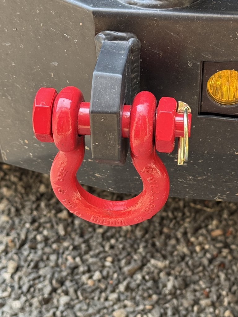

    This summer while navigating about 40 miles of old FS roads in MT and ID, I lost one of the shackles I had on the front bumper - there was apparently enough vibration to cause the standard pin to back out and that's the end of it.
    So I decided to replace them with something that should be a bit more "vibration proof":
    First, I grabbed a couple of Crosby 3/4" S-2130 bolt type bow shackles (Crosby part number 1019524). These ones are all red, and they use a cotter pin to retain the nut.
    Then I picked up some 3/16" linch pins to use in place of the cotter pins.
    So I replaced the two on the front bumper and the one on the Agency 6 rear hitch mount, and then put the two screw-pin shackles in the tool box under the rear seat.

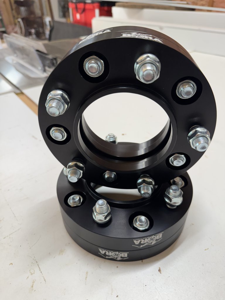

    Planning anything different for mud flaps or flares with the added poke when using the spacers?
  7. Sep 7, 2024 at 2:18 PM
    #1117
    RainMan_PNW
    RainMan_PNW [OP] "Oz" SSEM #82 RGBA #4 Unofficial Forum Treasurer Vendor?
    Oct 27, 2020
    #54134
    16,488
    Casey
    Clark County, WA
    2021 Lunar Rock TRD Pro CM
    not currently

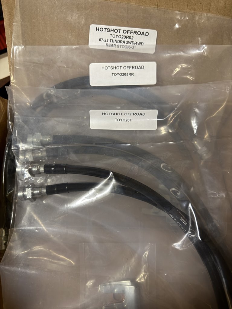

    Couple more things showed up from Hotshot…

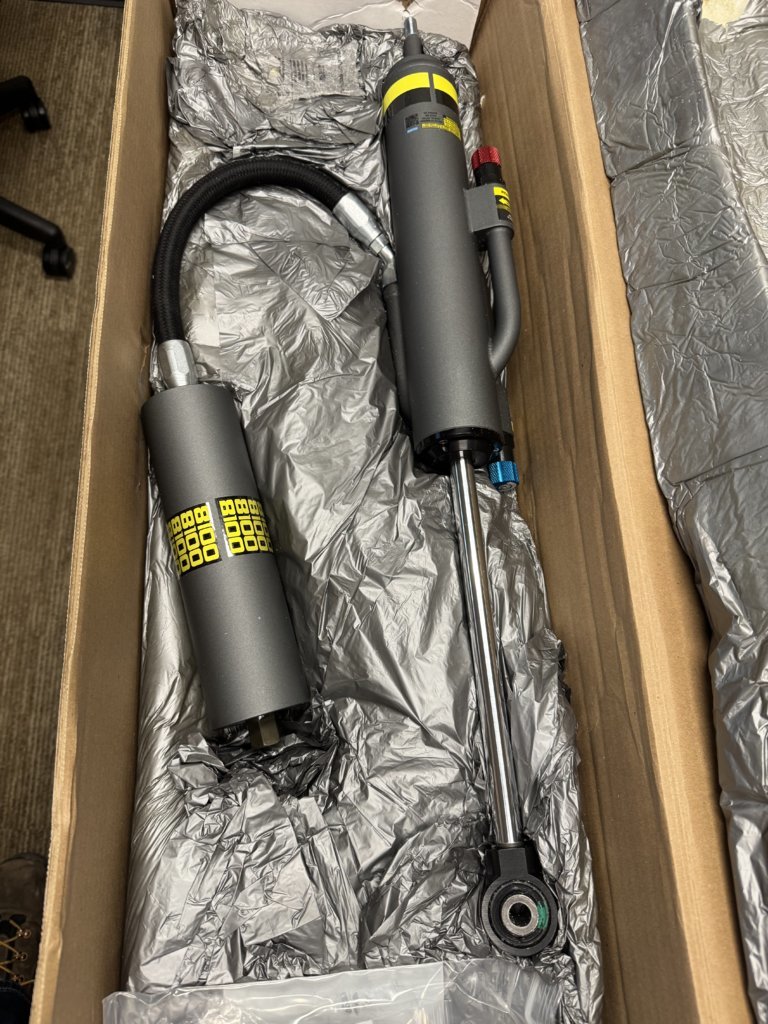

    Not going to get anywhere with this install this week.
    UPS still has one rear shock “in transit” even though all of them shipped together. And I’m waiting on a couple other bus and pieces to do while I have it all tore apart

    Currently not planning flares.
    These are only an inch, and I’m on the fence between sticking with 295’s or going to 285’s for tires later this fall. I’m also going to see how everything fits/looks without the spacers first.
    And, in the end, I’m not against a small flare (not a fan of the big pocket flare look) if necessary…but I’m also not the most gentle on my paint either.

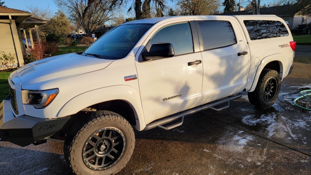

    When I did the lift on my 2012 Tundra, I also got Method Grid wheels and Nitto Ridge Grapplers (which I got rid of for Cooper Discoverer tires) and ended up getting some Bushwhacker no-drill smooth flares. What a hassle that was. The front flares were fine, one per side, but the shipment had 2 left side flares, and I didn't check them when I took them to the body shop to get painted, then I had to get another set of rear flares, and have them painted. Still didn't prevent everything from spraying up the side of the truck because there were no mud flaps with 31" tires on a 20in wheel, and a front body mount chop.
    I'm not going to worry about the paint on the 2019 TRD Pro like I did for the Acura MDX Type S Advance I owned for a couple of years between Tundras.
    Really wish I had kept this.

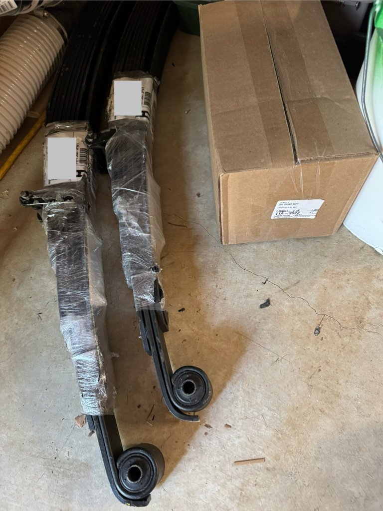

    Another piece came in…

    since when does hotshot @memario1214 brand brakelines?
    Mater and TRDFerguson like this.
  30. Oct 19, 2024 at 9:23 AM
    #1140
    TRDFerguson
    Oct 18, 2018
    #20730
    10,415
    Jake
    Southeast Greater Basin, AZ
    2018 MGM CrüeMax
    Dude. Get the ‘net.
    I think he sources the same ones as SDHQ. They’re on my short list.
