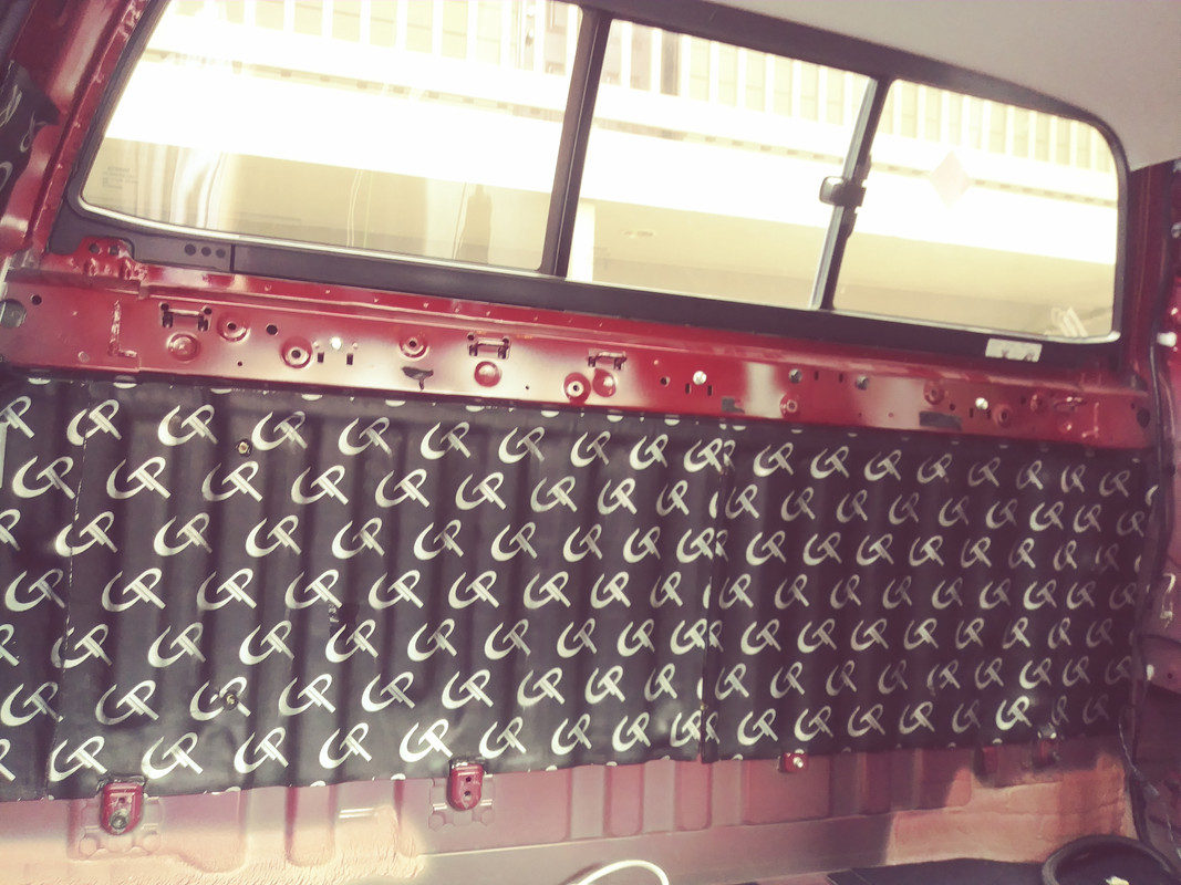

    Finally installed some of the GP Audio sound deadener. It goes across the back of cab, and I ran some inside the hollow areas of the rear pillar. I was very surprised of the difference that small amount made. I think the back of the cab was absorbing/reverbing a lot of sound because now it s like I have better mid bass speakers. I actually hear deeper bass. A few times I heard deep bass while driving, and looked around at all the cars around me to see where it was coming from, and realized it was coming from my truck.:D

    Modern idea is that you only need about 25% coverage of sound damping to get pretty much 90% of the benefit. If you want to block out road noise (rather than just shut down rattles) you need to go the mass loaded vinyl route. I did the full damping, ccf, and mlv. The acoustics in the cab are excellent. But it took me 40 hours and that was after I did the sound damping. (and I used too much!)
    read more here:
    https://www.sounddeadenershowdown.com/
    Twinky likes this.

    You hear this and that. I ve researched the sound deadening/proofing idea for some time, but when it came down to actually applying the deadener, a few taps with knuckel told me if the area needed some or not. For me, any flat surface that s floating; that has a hollow echo when tapped, will get deadener. Logically, it makes sense; all the areas that have this hollowness adds to the total loss of sound quality, so I figure, every area I deaden is an improvement.

    Oh yeah, I agree mostly. Cover more = it will help. Diminishing returns and all that and sound damping is expensive compared to mlv on a sq ft basis. MLV made a much bigger difference than damping in my 02. I highly recommend if you are willing to put in the massive effort. People have measured these things as well.
