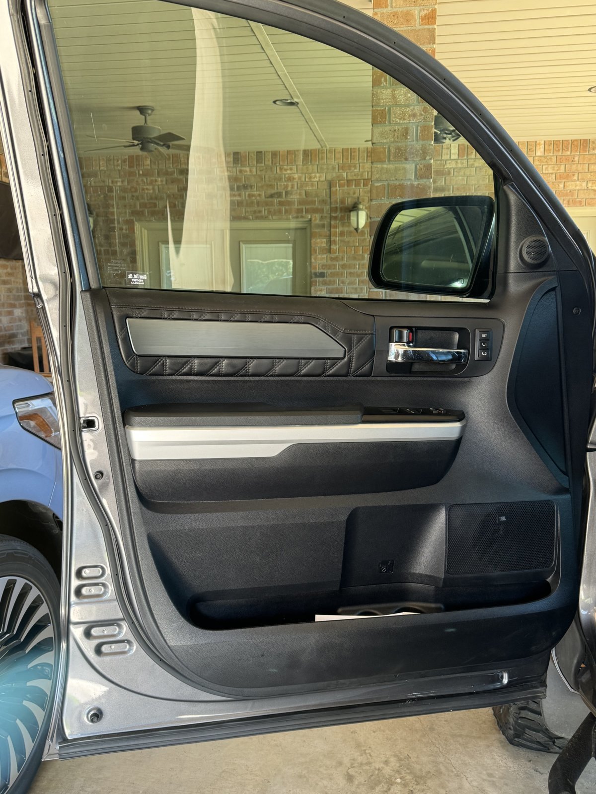

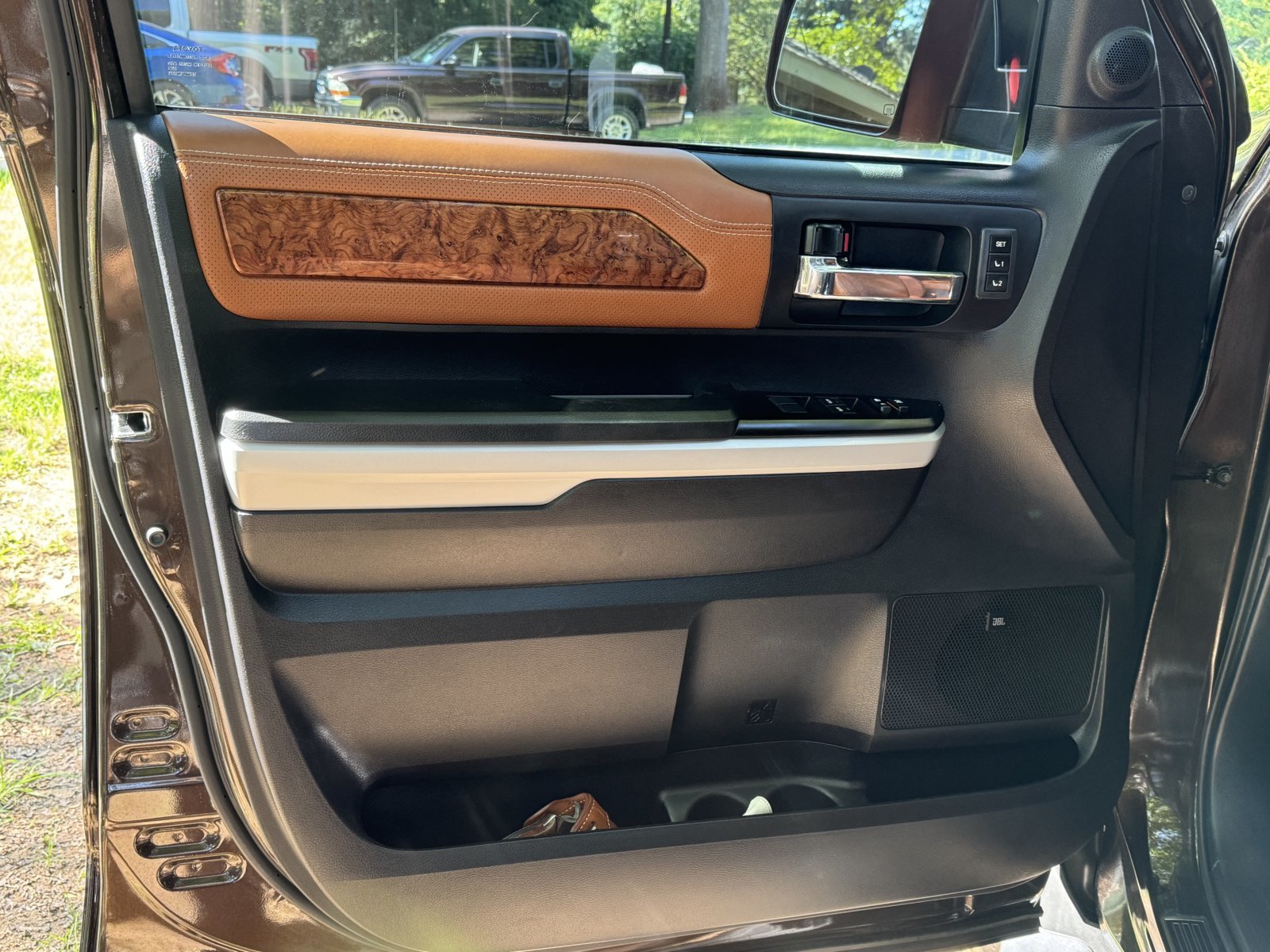

    Update all 4 of mine are doing it. Tint over factory and covered since new to me in 2017.
    I took some pictures of my buddies new to him 2020 and his panels look just like my 2014. Has anyone found a solution or newer panels yet?IMG_2340.jpg IMG_2335.jpg
