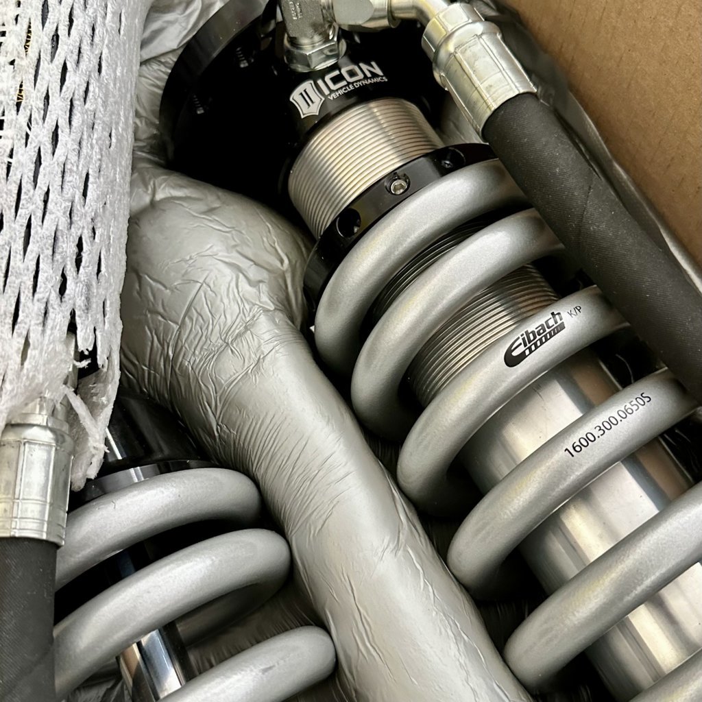

    Oh, hey, look what I just picked up from the shop
    SAGE63, BlueRibbon4x4, BillyB and 7 others like this.

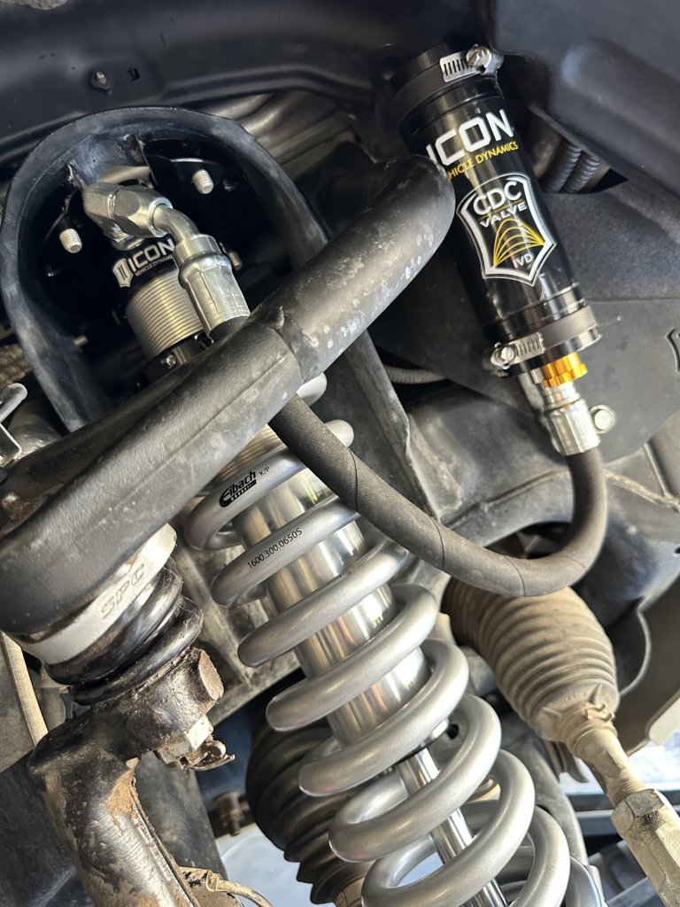

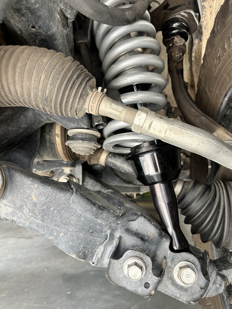

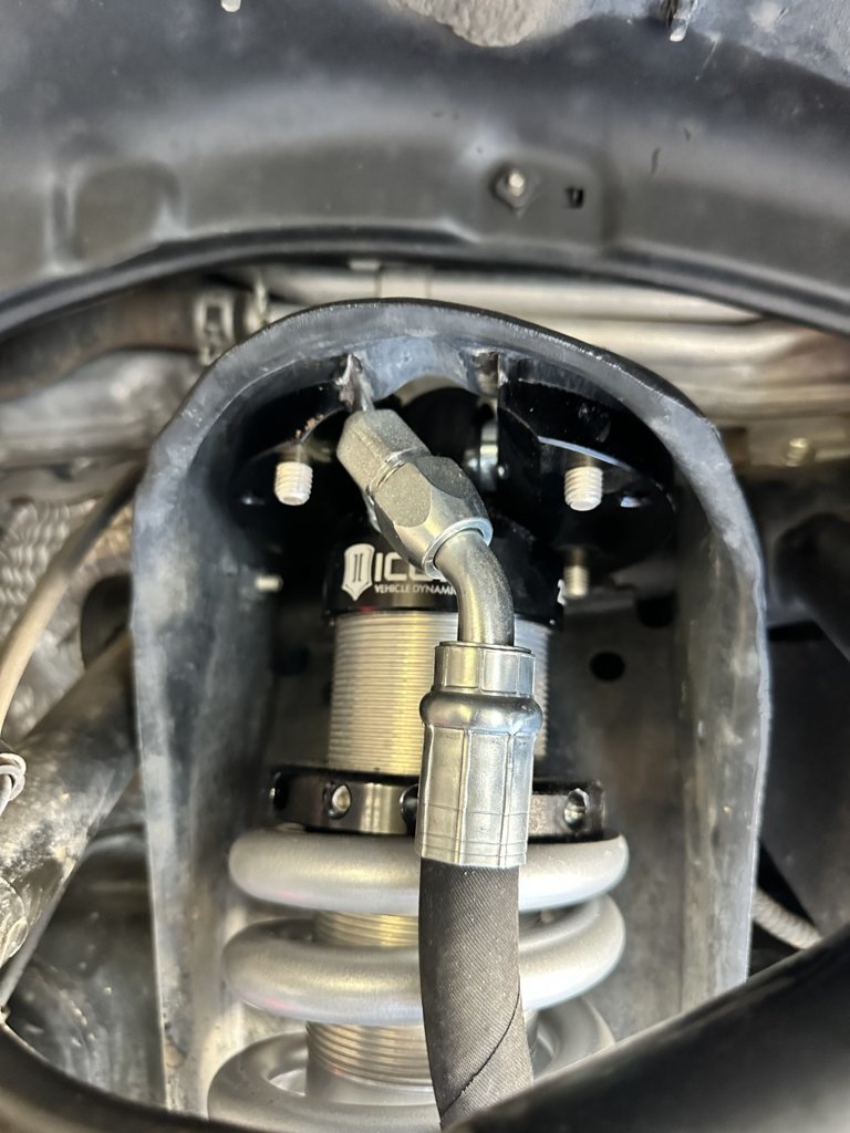

  13. Aug 30, 2024 at 8:21 PM
    #1783
    TRDFerguson
    TRDFerguson [OP] SSEM #99/RGBA #8-ish?/It’s a funny name.
    Oct 18, 2018
    #20730
    10,314
    Jake
    Southeast Greater Basin, AZ
    2018 MGM CrüeMax / 2024 Sequoia Capstone
    Spent some time between work calls yesterday to dick around in the garage. The coilover swap went well. Would have been easier with a second set of hands, but who doesn’t enjoy bouncing on a big fucking bar while trying to get the lower shock mount to seat in the LCA?
    An issue that I discovered, which I didn’t notice the first 3 times I messed with installing these, was that Icon REALLY doesn’t want you to use a shim on top of their shocks. Unfortunately for them, I own an angle grinder.
    The shim was dented to shit from the resi hose elbow contacting it from articulating at speed. Shouldn’t be a problem now.
    Then today… was going to knock out a quick preload adjustment. Unfortunately, the spring compressors shifted when loading them and made me shit my pants. I was not wearing my brown pants.
    @BiggHertz came over to give me a hand with walking the compressors back and getting the spring re-seated. 20 mins later, we were good to go. @AT x AT and @KevinK even showed up for moral support. Now I’m sitting about where I wanted, around 2.5-3” of lift over stock, with the Ironman bumper and OVS winch. Time to get it aligned and go beat the shit out of it.
    Big thanks to @memario1214 and @BiggHertz for helping out on this
